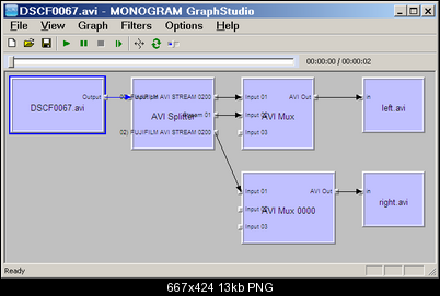

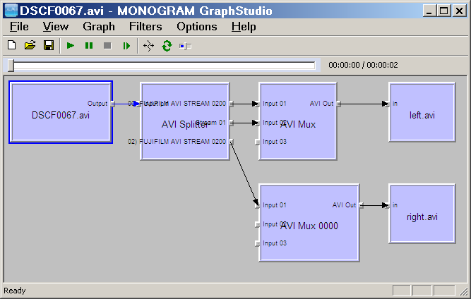

  6. Not many tools can deal with the dual video streams. Here's a graph from GraphStudio that will split the video into two AVI files:
    On the left is the File Source (Async.) filter. The output from that is routed to the AVI Splitter. The left video and both audio channels are routed to an AVI Mux filter, the right video output to a second AVI Mux filter. The two Mux filters are routed to separate File Writer filters, left.avi and right.avi. After "playing" this graph you will get two AVI files. Only the left one will have audio.

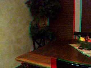

    Here's an AviSynth filter that will create a color anaglyph:
    left=AVISource("left.avi").ConvertToRGB()
    right=AVISource("right.avi").ConvertToRGB()
    red=ShowRed(left)
    green=ShowGreen(right)
    blue=ShowBlue(right)
    MergeRGB(red,green,blue)

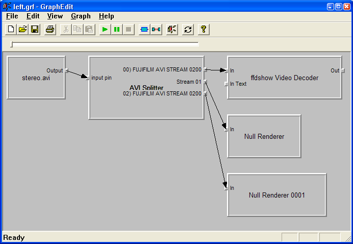

  8. I believe you can build two capture graphs, one for the left stream, one for the right stream. Then use a pair of DirectShowSource() filters to read from the two graphs.
    <edit>
    Yes, I just tried it and it worked.
    left=DirectShowSource("left.grf", audio=false).ConvertToRGB()
    right=DirectShowSource("right.grf", audio=false).ConvertToRGB()
    audio=DirectShowSource("audio.grf", video=false)
    red=ShowRed(left)
    AudioDUb(MergeRGB(red,green,blue), audio)
    Since DirectShowSource() requires only one pin be active in the GRF file I routed the unused pins to the Null Renderer filter. For example:
    </edit>
