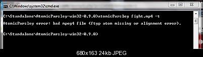

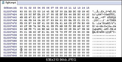

    To repeat from the other link as well as here, that file looks like toast inside I'm afraid. It shows to be 90+ MB in size when in reality its 12,357,535 bytes with no structure, mp4 atoms or alignment at all and the rest is hex '00'/nothing/null.
    Don't know what Recuva Recuva'd but it isn't much of an mp4 file. sorry.

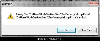

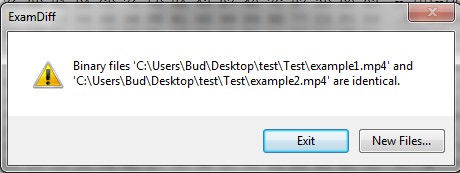

    Nope sorry... The two files are identical Exactly:
Name:	ScreenHunter_05 May. 11 23.56.jpg

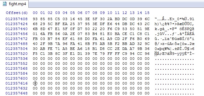

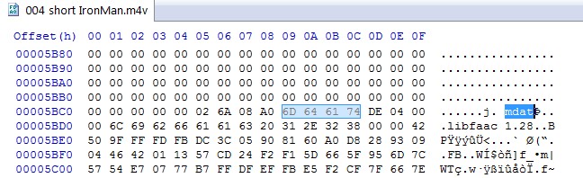

    And they contain no MP4 attributes at all. The intermittent Null areas ( Hex "00") are not unusual in some converted/restored/created MP4 files but what is unusual is that there are no atom identifiers immediately before or immediately after as in:
Name:	ScreenHunter_05 May. 12 00.18.jpg

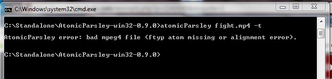

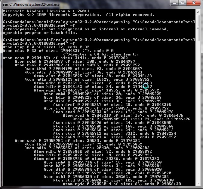

    And running AtomicParsley with -T attribute generally shows a lot of necessary atoms in an MP4:
Name:	ScreenHunter_05 May. 12 00.14.jpg
    These files do not appear to be just truncated MP4 files, at least not with the tools I usually use to repair mp4 files.
