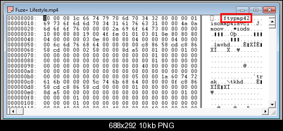

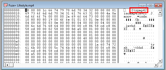

    Originally Posted by snadge View Post
    I wouldnt know what Iam looking for in a hex editor
    Most media files have very distinctive markers near the start or end of the file. You can see these with a hex editor. MP4 files have the text "ftypXXXX" near the start, where XXXX varies (avc1, mp42, qt, isom, etc.):
    JPEG images have an obvious "Exif" or "JFIF" at that same location.
    Most media containers use variations of the old "tagged image file format" where such four byte tokens are used to identify chunks of data. Someone who knows what they are doing can identify those tokens and reconstruct the audio and video streams even if the critical header information was overwritten. If the file doesn't have the right data the expert can go back to the flash card and search for it.
    I suspect your 1.4 GB MP4 file has that JPEG data written over the first part of the file. The rest of the file may or may not be data from the original MP4 file -- file undelete programs often makes mistakes.
