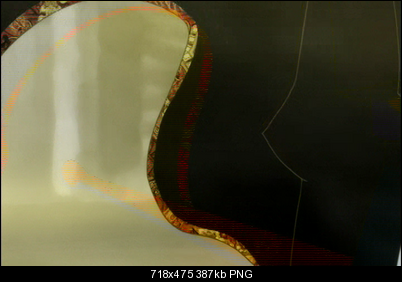

    Is that normal to happen after inverse telecine?
    I'm getting this shown in MeGUI since I'm not too confident I could handle all of AviSynth.

  2. Originally Posted by Weef View Post
    No.

    Any idea what it could be?
    MeGUI is generating this line after analysis
    tfm(order=-1).tdecimate(hybrid=1)
  4. It looks like mishandled interlaced chroma channels. Was there some other filtering before tfm/tdecimate? Is that shot in one of the samples you uploaded?

    Well, the script doesn't do much.
    And, no, it wasn't in one of the samples before like this.
    DirectShowSource("F:\Kreativ Eck\DVD Rips\Gankutsuou\VTS_01_1_.MPG", fps=29.970, audio=false, convertfps=true).AssumeFPS(30000,1001)
    that's the only thing more the script does besides resizing
  6. Sometimes you have to use some of the other parameters of TIVTC. Sometimes nothing fixes it. Please provide a sample that includes that frame. Not a sample of the end result, but a sample from the source.
    You should do your own analysis. More often than not that Hybrid=1 part is incorrect.

    I tried it for now with a different sample and it just seems like MeGUI is not always allying the changes....in the other sample it worked.
    So for now I would say it's not a real problem of concern but was more than surprised when I first saw that o.o
