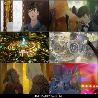

    I've been asking myself if it would be really a wise choice to deinterlace this DVD material.
    Mainly because of these reason that the used patterns are very filigree and I want to loose as little detail as possible.
    Additionally the 3D Models in the surrounding are already not rendered with the most exact light and seem blurry here and there.
    Other thing is, that I already had to bring it to the format of 752x480 which seems closer to the original ratio.
    Should I really risk loosing too much video information in this personal project, I've been wanting to edit and translate for years? That's already the export in uncompressed 4:2:2

  9. In your screenshot, the top right image has combing in the eye , middle right and bottom right shows some bad interlaced chroma upsampling artifacts (but might be the way you took the screenshot, or the editing software you're using; hard to say without more information)
