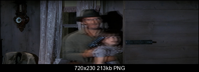

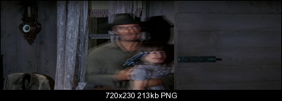

    { After Using QTGMC }
    This blending frame is very stubborn and even QTGMC couldn't decimate it completely.
    So, may I ask what will be the best solution to deal with this kind of fast-moving scene?
    BTW, comparing to TIVTC, QTGMC is more efficient. But, as far as I was concerned, it do some frame interpolation which TIVTC doesn't do. And for some sources which are not "really interlaced", I've been told to follow such rules:
    (1) For PAL interlace: yadifmod(edeint=nnedi2())
    (2) With NTSC DVDs, if they are 100% film: tfm(pp=0).tdecimate()
    (3) If they are not 100% film (for example, 99.99% film or less), choose from these two for the more efficient one:
    tfm().tdecimate() or tfm(order=1).tdecimate()
    Now, since I knew QTGMC was efficient but slow, I want to use it all the time without caring about the percentage number given by the d2v file. Is this a good solution? Could I use the following code all the time to deal with interlacing and blending (Obviously, in this example, QTGMC is not enough)?
    WILL QTGMC DO HARM TO THE SOURCE? (That is to say, apart from decimating interlacing and blending, will it do something harmful to the source other than restoring?)
    AssumeTFF()
    Import("D:\Program Files\Megui\tools\avisynth_plugin\QTGMC-3.32.avs")
    QTGMC()
    Merge(SelectEven(),SelectOdd())

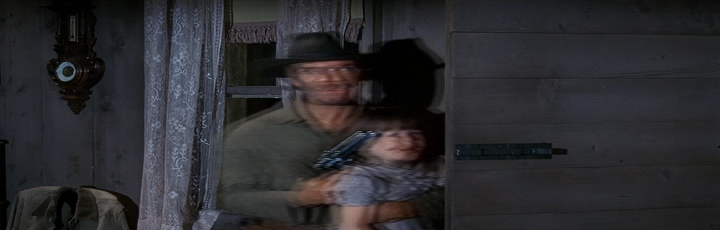

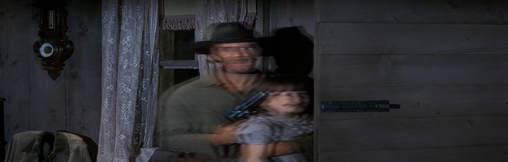

  2. This is another movie, needless to say it's another totally different source. But the situation is resembled.
    Take a look at Gregory Peck's action.
    { Before }
    { After }

    { After }
    Or maybe it's due to the fuzzy original source.
    Also, take a look at the walking person in background. The original source was blended a bit, but after QTGMC' filtering function, it has been decimate perfectly.

  27. Here it is, the clip, which contained both blended and interlaced artifacts, and couldn't be decimate by srestore or deblend.
  28. There is no field blending in that clip. It's the same as the other clips but has a phase shift in some frames (some frames contain fields from two different film frames). Using Merge(SelectEven(),SelectOdd()) after QTGMC() is causing the blended frames when the two fields are out of phase.
    For example, when using:
    AssumeTFF()
    QTGMC()
    frames 0 to 10 are in phase and show no blending artifacts. The rest of the frames are out of phase and show blending artifacts.
    Using:
    AssumeTFF()
    QTGMC()
    Trim(1,0)
    shows frames 0 to 9 with blending, the rest with no blending.
    An automated way around this might be to use TFM() first, then follow with QTGMC() and Merge(...). It worked for this clip but could cause problems with others.
    AssumeTFF()
    TFM()
    QTGMC()
