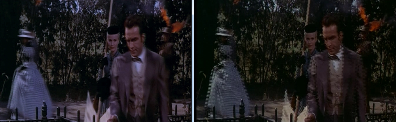

  4. More aliasing frame...

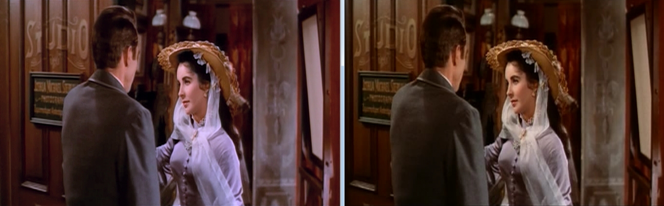

  8. I've been doing some color correction towards this source.
    After / Before

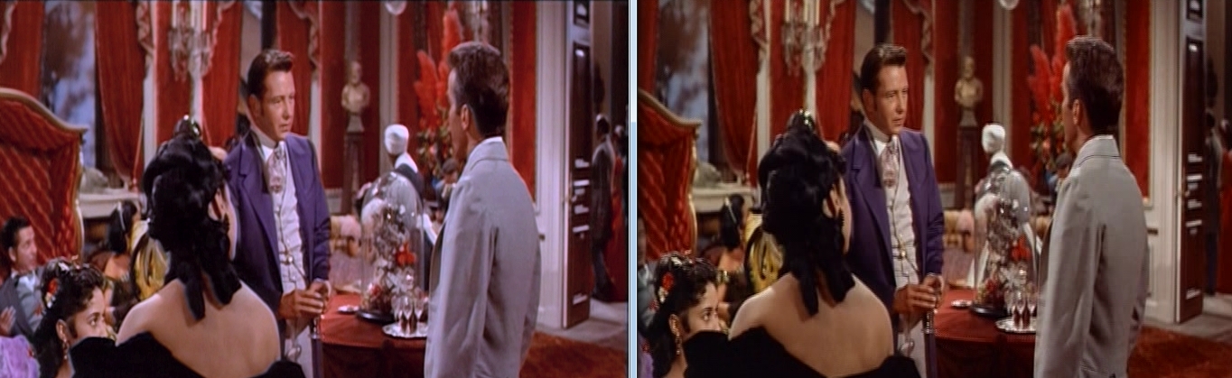

  9. After / Before (Color correction, anti-aliasing, deinterlaced)
  10. The original color is a little yellow, I switch it to purple a bit.

  11. Way too purple.
    I didn't find anything that worked better than the QTGMC() code I gave earlier. You might follow up with a small vertical sharpen.

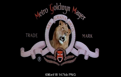

  14. I've met with a new problem, you see, the background color black is a bit mess and mixed with other color
    Then use some 3d noise reduction.

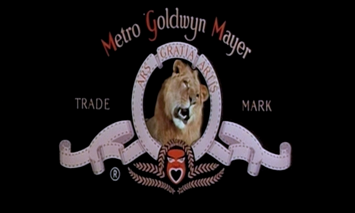

  22. An example of luma mask method, crushing black level . You can apply different filter or method through the mask (instead crushing black level ) if you wanted to

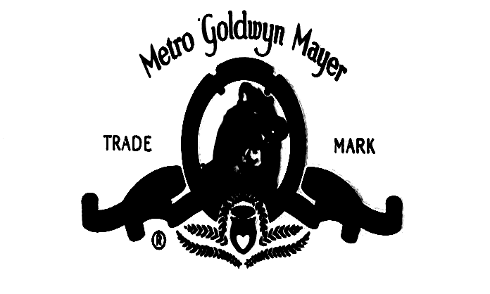

    To visualize the mask (in order to tweak the mask, e.g. you might have to adjust black b=, white w= parameters), use show=true, upper = true/false to invert the mask. Filtered versions pass thru the white areas, original is passed thru the black areas

  23. Thank you And could this LumaMask tool been apply to the whole movie or just this frame? It is easy to catch other mixing black color in other frames of the source.
  24. Code:
    orig=last
    orig
    Levels(16,1,255,0,255,false) # crush black level
    Lumamask(orig, b=30, upper=true, w=100, show=true)
    orig=last
    orig
    Lumamask(orig, b=30, upper=true)
    I've tried LumaMask on another frame, just think it makes the scene darker, and the dark area looks purely black, seems have lost the detail gradation.

  28. Originally Posted by xuguang_he View Post
    Do you understand why ?
    You obviously can't use the same lumamask settings for the entire movie. At minimum you have to adjust the mask settings for black e.g. b=something
    100% Black => passed thru
    100% White => filtered
    Greyscale => intermediate
    Since all shades of grey have varying levels of filtered vs. original clip that are passed through, have a closer look at your mask . All those white areas in the mask corresponding to the dark areas in the real movie will be crushed! All the areas that are grey in the mask will be darkened by an intermediate amount. That probably isn't what you want to do with other parts of the movie.
    You have to adjust the mask values, or use another filter approach applied through the mask
    If this is the same movie as the screenshots above, I doubt you need to do anything with a lumamask on the main movie
    You're supposed to learn from the examples , not apply them blindly to everything
