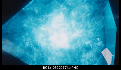

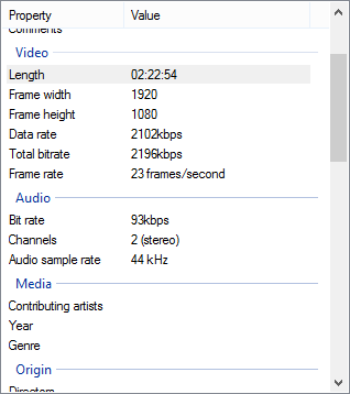

  1. I found a really beautiful version of the Avengers that is in MP4 format at 2.2GB. When I look at the details of the file, the specs don't look too good. But when I play it, the picture is absolutely gorgeous.
    So I wanted to see if I could convert my blu-ray of the Avengers to look that good. I backed it up to my hard drive. Then used a couple of tools for the conversion. DVD Fab, AVCWare and MediaCoder. They ALL look horrible.
    What am I missing? I looked at some of the How To guides and didn't find anything that helped (there are a lot there so I may have missed it).
    If someone knows of a better conversion program (CUDA support would be nice) or a check list of settings that I need to check, then that would be great. I am now using some of the shorter videos on the DVD like gag reels to test with so the conversion goes much faster. If you need me to post any screenshots or videos then let me know and I will do so. I would really like to finally do this right.
    Thanks,
    Mark

    Ripbot can do a target bitrate. The total bitrate there is 2100 something.
    However please note its stereo in the screen shot you posted. If you want 5.1 you'll either have to reduce the video bitrate a bit or live with a slightly larger file size upon output. Also use ac3 rather than dts to save space on a 5.1 track. Eac3to is the tool to do that.

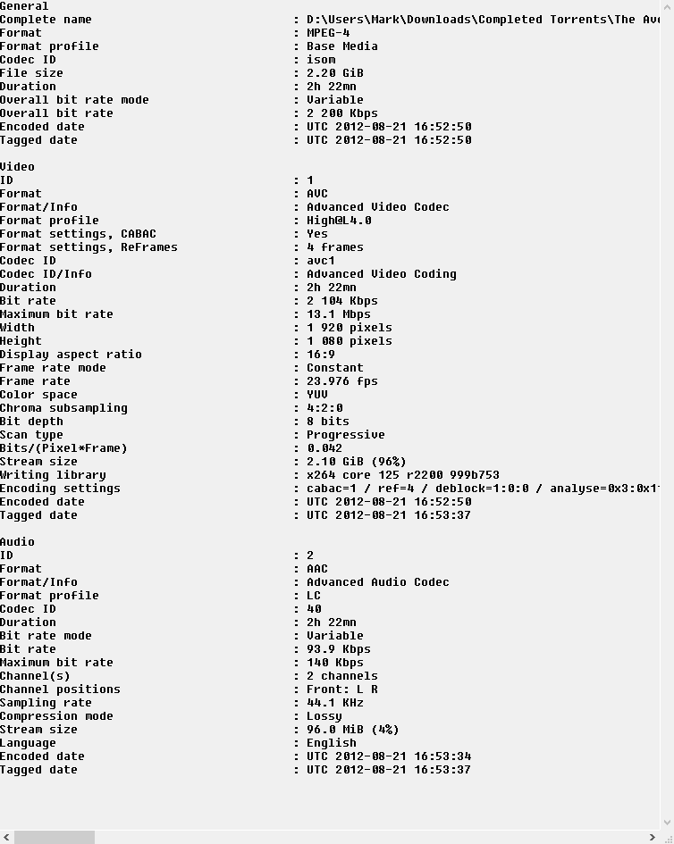

  11. Thank you very much. I will post the mediainfo when I get home. See if I am missing anything. I got a little closer with Ripbot264. That app seems pretty fast. Does it support cuda? I didn't see it in my brief skimming of the product page on videohelp.com.
  12. First off I want to say thank you for all the help this community has given me so far. I hope to be able to contribute when I learn more.
    Here is the mediainfo for the Avengers.mp4
    I will play around with more settings and such to see how things go.

  14. Is there a piece of software that I could export the encode settings from mediainfo to and have it encode the files exactly the same?
  15. x264 was the encoder. The Encoding Settings line tells you what settings were used. The video may have been run through a noise reduction filter too. Noise is the enemy of compression. Forget CUDA if you want quality.

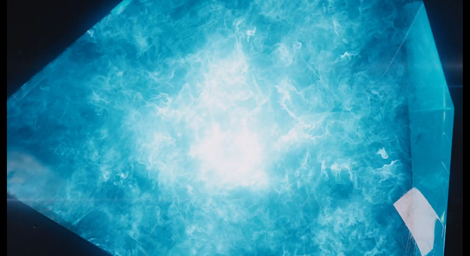

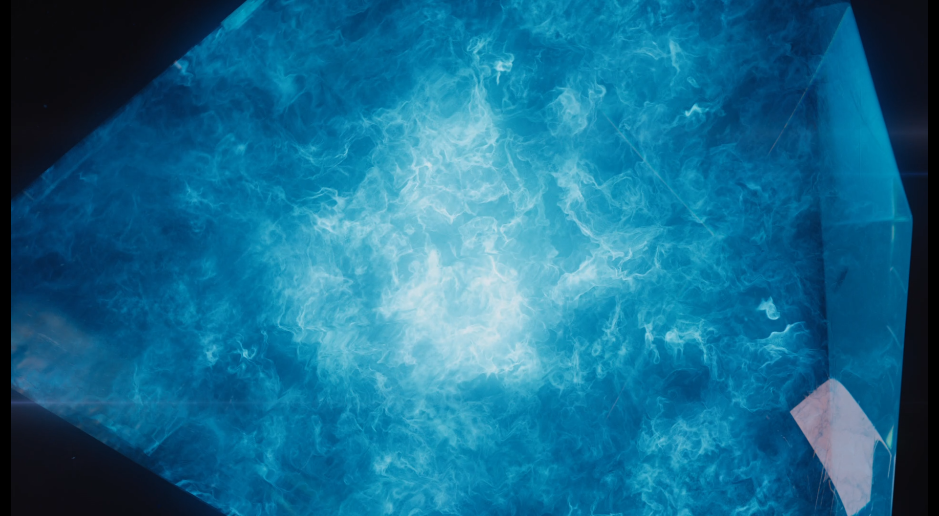

    Here are 2 screenshots. I think you are right. I didn't get up close and really look when i did a side by side video. Here is a paused screen and you can definitely tell.
  18. All the small, low contrast, details are gone and the levels are screwed up.
  19. //EDIT- sorry I understand what you mean. Read it wrong.
    Top is MP4, Bottom is BluRay.

    Here are 2 screenshots. I think you are right. I didn't get up close and really look when i did a side by side video. Here is a paused screen and you can definitely tell. (graphics removed to save space)
    Well...I can see a big difference in brightness, but not so much in image detail. Yes something is different, but not necessarily quality. If that was a radiograph, I'd still see what I was looking for. I might want to tweak the settings to see it more to my liking, but that's it.
    Back in my analog days, it was SOP to use proc amps to adjust the various parameters to preserve (or restore) the picture quality while staying within the confines of the NTSC broadcast format. No doubt similar corrections need to be made in the digital domain. I don't envision the people who make their living doing HD post production revealing all their secrets so that you can do it at home though.
    When I was a video pro, the cost of the hardware kept the masses out. Today it's the technical know-how. It goes beyond knowing the best command lines. It requires looking at the displayed image and saying "I think it looks better this way". That's highly subjective thinking that's not easy to teach or learn.

    i can see a lot of difference in the detail , between the two images
    if i was doing a lab anylasis of the tesseract , i would want the bottom original disc image
    however as a movie to be viewed , the center of the tesseract is only on the screen for a few seconds
    and i am more intetested in the actors and the action scenes
    'viewer' quality is so subjective
    i have that movie in DVD,
    now i need to do a screen shot and compare your shots to mine
    my personal opinion is when you reduce BD by a factor of ten,
    you have removed so much detail and compressed it so much, you might have a better viewing experience watching the dvd release
    i can't understand compressing a BD to where quality is less than DVD
    frame size alone is nothing , if it is not populated with sufficient digital data
