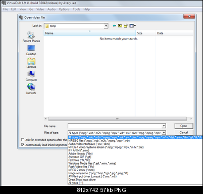

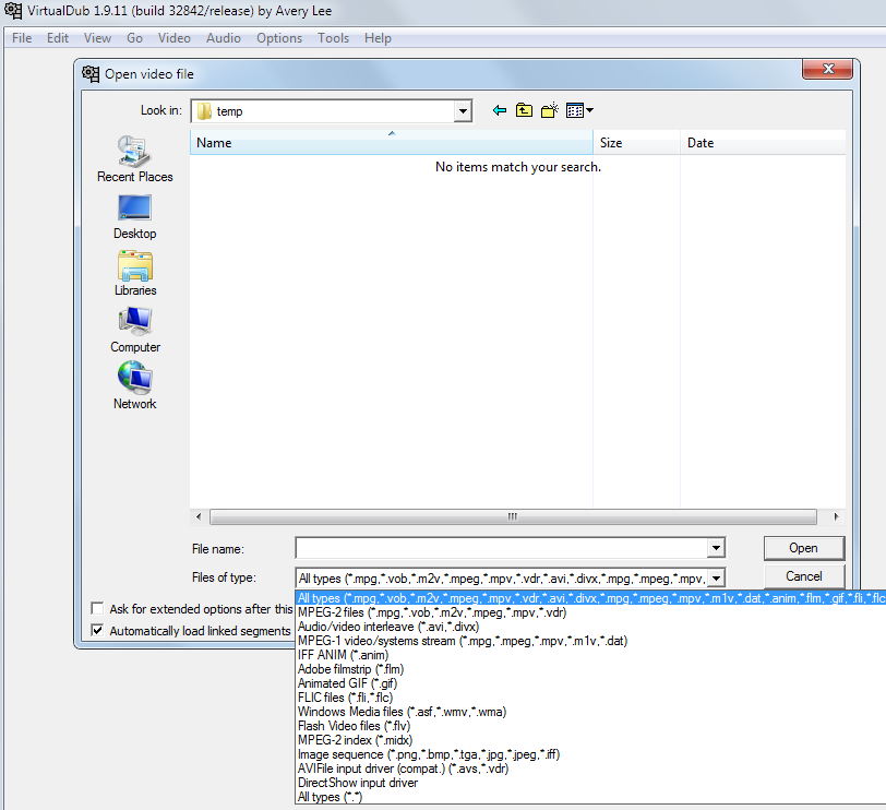

  12. I meant the "files of type" box ; see the edits I made in the post above and the screenshots in that linked thread (see screenshots in post #9)
  13. Jesus. After selecting Open Video File use the Files Of Type pulldown (near the bottom of the file dialog) to select which source filter you want to use:
    You must download and install the appropriate source filters before this will work. See the import plugins/filters section here: https://www.videohelp.com/tools/Virtualdub
    [Attachment 17303 - Click to enlarge]
