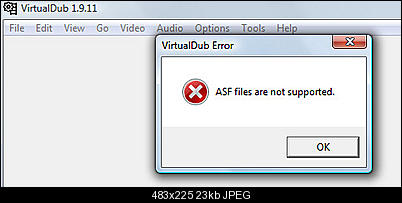

    I'm at the early stage of opening the video file. When i open file i get
    What plugin do i need to install for wmv video files?

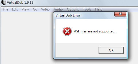

    No good, i'm getting the ASF files not supported sign again.
    Am i missing something else?
  4. You can try renaming extension to .wmv
    or
    You can try the ffinputdriver for vdub
    http://code.google.com/p/ffinputdriver/downloads/list
    or
    directshow input driver for vdub
    http://forums.virtualdub.org/index.php?act=ST&f=7&t=15093
    or
    you can open it with an avisynth script
    e.g.
    FFMpegSource2("video.asf", atrack=-1)
    http://code.google.com/p/ffmpegsource/

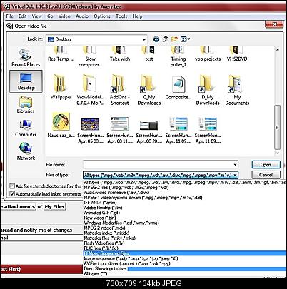

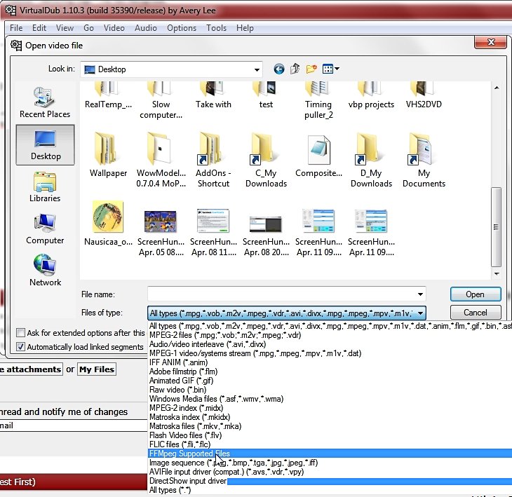

  8. Member Budman1's Avatar
    Jul 2012
    NORTHWEST ILLINOIS, USA
    If all else fails download the filters PoisonDeathRay listed, especially the DShowinputdriver and the FFinputdriver and then when you open the file select the FFmpeg of Dshow input choices and then select your video. It should open fine since Dshow uses the same filters Windows uses and FFmpeg uses ffmpeg to decode.
Name:	ScreenHunter_486 Apr. 11 11.47.jpg
    This will also help determine if something else is wrong, as might happen if Dshowinput fails or ffmpeg fails also. Give these a try since they are great filters to use for all types of files.

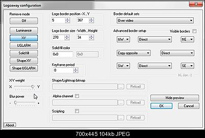

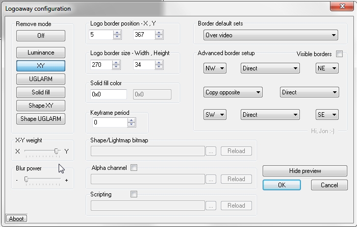

  11. Member Budman1's Avatar
    Jul 2012
    There is a pretty good guide at http://www.scribd.com/doc/6199498/MSU-Logo-Remover-UserGuide and a video at http://tutorials.downloadroute.com/video-173579.html for MSU logo remover. If you have problems there are several others that work well, especially for the scrolling type. I prefer Logoaway V4.01 especially if you play with the blur and x-y weight.
Name:	ScreenHunter_486 Apr. 12 23.18.jpg
    Delogo is also excellent but you will also need a manual that can be read and downloaded at http://neuron2.net/delogo132/delogo.html.
    It is difficult to completely remove some logs completely and make them invisible so I just threw in several I use depending on the type Logo you wish to remove in case one doesn't work well for you.
