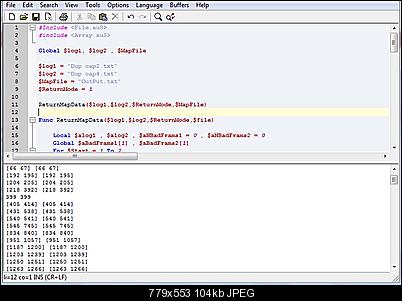

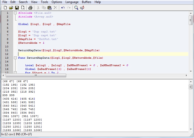

    Example:
    the script:

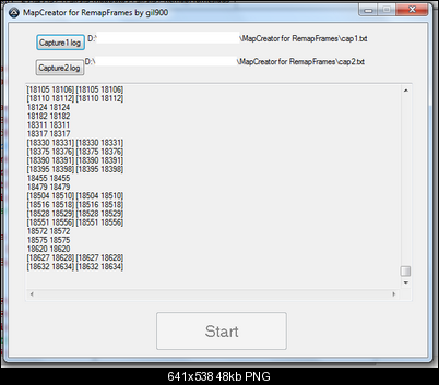

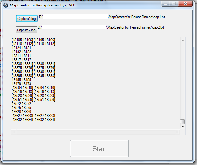

  2. I made a tool for this purpose.
    The new tool does an excellent job! I speak from experience.
    Previous script deleted. The algorithm returned the data but with a fatal error.
    The new tool:
    Download:
    (Attachment)
