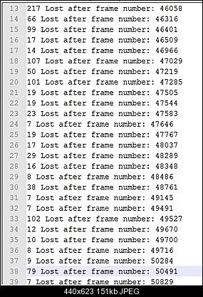

  9. Update:
    i worte a script that give readable information
    you can set in the script from how much lost frames he will write..
    if it useful to someone so tell me and i will work for little gui and share it...
