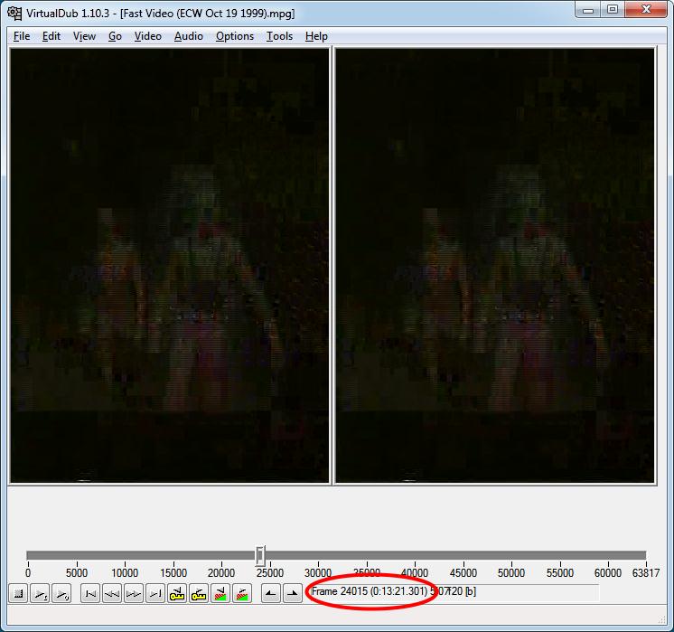

  18. That script doesn't work with that video because the last frame number on line 47 "Mappings="[29051 74379]" is larger than the number of frames in the video. Replace 74379 with 74377.
    If you had looked at the error message AviSynth returned you would have seen this.
  19. The video is made longer by slowing down the speed which is why there is more frames than before. I looked at the video in AvsPmod and 74379 is the last frame?
  20. 74377 is the last frame. Maybe some of the time stretching functions have changed a little?
  21. Ok it looks like when I re-encoded the video for uploading that a couple of frames were removed. Anyway, do you know how to fix the problem where the middle part of the video is slowed down instead of staying at the speed it originally was?
  22. The middle part of the video isn't sped up here. Are you sure you're looking at the right part of the video? Remember, part A is longer than it originally was so part B starts later than it originally did -- around frame 34511 rather than 28788.
  23. In the video I uploaded the middle part plays fine but when I use the script I posted it slows down the middle part for some reason. Yes I'm sure the frame numbers are correct.

  29. I don't understand that because when I load my script in AvsPmod the start and end trims are trimming the exact sections that I want slowed down? Yet when the video is encoded it's not slowing down the correct sections. Here are the the trims and trim times and also I've shown the times in the video with no script. What am I doing wrong?
    1st Part (needs slowed down): Trim(0,28787) # 0 - 16 minutes (0 - 13 minutes 21 secs in the video before the script sees it)
    2nd Part (does NOT need slowed down): Trim(28788,39486) # 16 minutes - 21 mins 57 secs (13 minutes 21 secs - 18 minutes 46 secs in the video before the script sees it.
    3rd Part (needs slowed down): Trim(39487,74377) # 21 minutes 57 secs - 41 mins 21 secs (18 minutes 46 secs - 35 mins 29 secs in the video before the script sees it)
  30. 13 minutes and 21 seconds isn't frame 28787 in the original video. It's frame 24006.
    (13 * 60 + 21) * 29.97 ~= 24006
