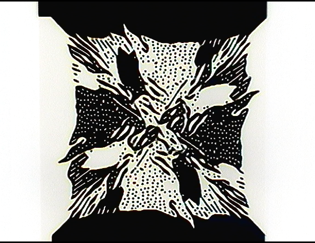

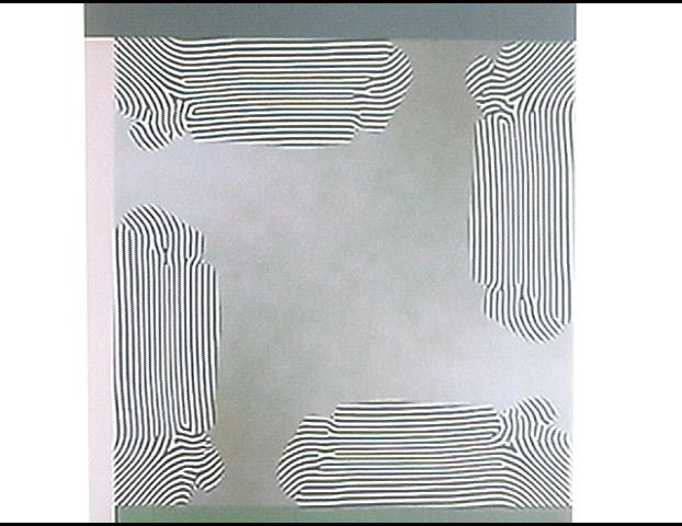

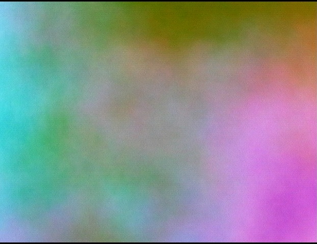

    You know what, I ended up going with the startech usb adapter. You can actually get it for about $10 cheaper if you get the original videohome release of the product through an Amazon seller here:
    http://www.amazon.com/GRABBEE-AV-Hi-Speed-Deluxe-Adapter-Grabber/dp/B003MWJ400/ref=sr_...bBeeX%2Bdeluxe
    I ended up paying the extra $10 to get it through Amazon for quicker shipping and easier to return if it didn't work for me.
    It's actually already sitting next to me and it works! Funny enough the best tech support seems to be coming from a reviewer on the product page for the startech version and pointed me to the updated drivers here:
    http://www.videohome.com.tw/vh_mana/support/file/GrabBee-AV_BDA_20100930_WHQL.zip
    The only thing that tripped me up was trying to get it to show up in virtualdub capture mode. It was giving me a green screen until I selected preview mode under 'video>preview'. You can also select the video source for composite or svideo in the video menu.
    Attached are some screenshots, I'm pretty happy with the quality.
