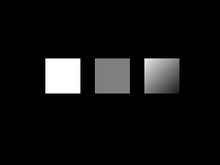

  7. You probably recall this much, but just in case... The basic concept of using alpha masks:
    Given two videos (I'm using two different colors to make what's happening very obvious):
Size:  618 Bytes + Name:  red.png
    and a mask:
    Merge them with mt_merge(blue, red, mask, true):
    Where the mask was black (the background) the first video (blue) showed through. Where the mask was white (left square) the second video showed through. Where the mask was a medium grey (center square) the two images were mixed 50:50. Where the mask was other shades of grey (right square) the two images where mixed with different weights. The true argument was used so that mt_merge() only used the greyscale channel of the mask to determine transparency.
