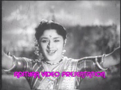

  3. I do this sort of thing with some frequency. For example, I recently had a video with a godawful logo smack dab in the middle:
    I wanted it for both YouTube and for a DVD project I was making. The logo remover could only blur it:

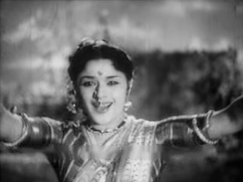

    So I found a video of the same song on YouTube, a video inferior in every way except it didn't have a logo. I cut out a small piece of it and overlaid it on top of mine:
    And here's the YouTube result.
    http://www.youtube.com/watch?v=PO_fvT3GlDs
    In spite of my best efforts to match the levels, brightness, and contrast of the 2 videos, I couldn't make it work quite right. I didn't (and still don't) know how to feather the edges, so you can sort of tell that the middle rectangle doesn't exactly match the rest of it. It's still way better than that horrible logo. pdr, how do you blend the edges? The AviSynth script goes something like:
    A=LogoVideo
    B=NoLogoVideo
    B=B.Crop(to the dimensions you want)
    Overlay(A,B,X=,Y=)#X and Y being the location where the logo is to go.
    Hmmm... I don't know how to put the pics where I want them. Top to bottom they're Original, Blurred Delogo, Final.

  4. Nice work, manono! Surely there's a way to feather the edges of the mask with avisynth?
