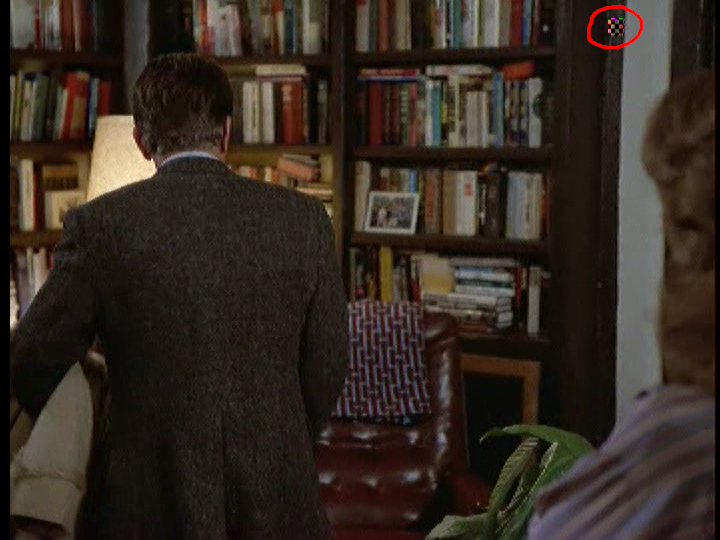

  6. I've encountered a few instances where a minor glitch or a hiccup in the source video causes the encoding process in Hybrid to abruptly abort and remux with no errors reported, leaving me with a outputted container file that has full duration audio but only partially completed video.
    This occurs when using VIVTC or TIVTC to inverse telecine, but does not occur when I turn those off.
    I've tried other software ranging from handbrake, to avidemux, to staxrip, and these will simply passthru the glitch/hiccup and continue encoding the video to completion. (StaxRip successfully completes even with TIVTC turned on)
    Is there some setting or method to configure in Hybrid so that it continues encoding the video to completion?
    Example attached:

    I skimmed through that thread, I'm not seeing how that helps with this.
    Ultimately I'm trying to figure out how to get Hybrid to not abort the video encode when it encounters this particular spot in the video.
    I assume it should be possible since StaxRip is able to do so even with TIVTC turned on.
  9. No problem here with your sample file using Hybrid's TIVTC (Avisynth). Maybe you submit the debug output to Selur's forum.
  10. Originally Posted by Sharc View Post
    Ah okay. It may be a vapoursynth issue specifically since that's what I was using. The StaxRip build on my other PC uses avisynth.
  11. It usually depends on the source filter, that said using your 'video-glitch-example-clip.mkv' sample with Vapoursynth and different source filters (DGDecNV, Bestsource(cpu), Bestsource(cuda), LWLibavSource(cpu), LWLibavSource(cuda), FFMS2) and TIVTC, I had no problem.
    => maybe check if you can produce the problem on your system with that sample if you do, share a debug output, so I can see what your script looked like.
    Cu Selur
  12. Originally Posted by Selur View Post
    Cu Selur
    I ran it twice using VIVTC (Vapoursynth) and TIVTC (Vapoursynth)
  13. Ah, you are on Linux and you use an old version (2024.09.29.1).
    => Try disabling BestSource and if you use BestSource update the used version.
  14. Originally Posted by Selur View Post
    Where? How?
  15. Disable "Filtering->Vapoursynth->Misc->Source->Prefer BestSource"
  16. Thanks. That worked.
