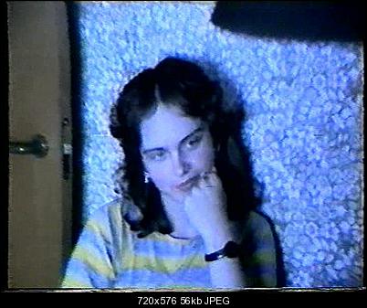

  1. Originally Posted by Asesinato View Post
    Ive played with alittle now... What do you think now?
    That's an improvement but now you have problems at the opposite end. Notice how the details in the dark areas of the woman's hair have become totally black in themaster1's sample images. You're definitely on the right track.
    Sanlyn is right that the "ultimate" fix is to get a time base corrector (either in an s-vhs deck or dvd recorder) but there is a lot you can do short of spending money on that. And if this is a third generation recording a TBC may not help much.
    I did a little noise filtering and quick color adjustments. It still has a long way to go but this is starting to get in the right ballpark.
    Before:
    after:

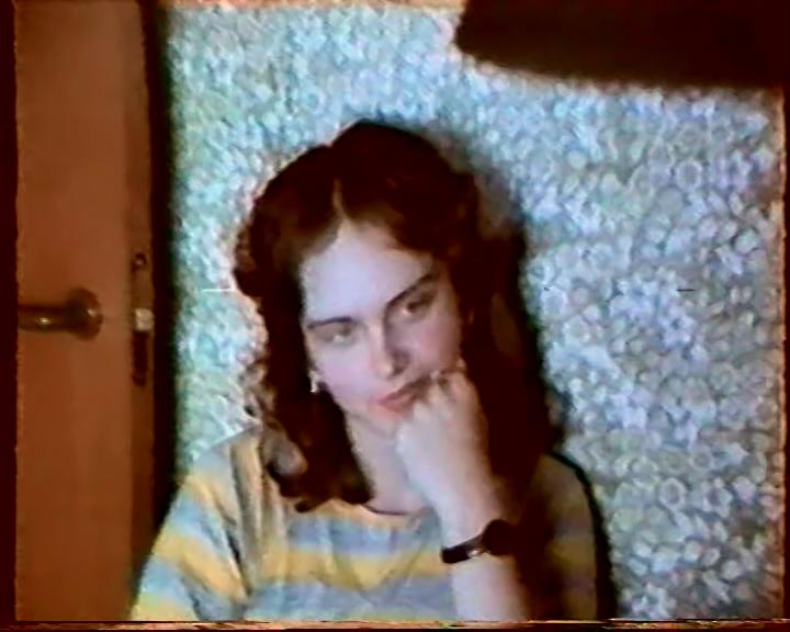

  2. here is the best i came up with so far:
    scene1 http://imageupload.org/en/file/210620/scene1.jpg.html
    scene2 http://imageupload.org/en/file/210621/scene2.jpg.html
    I've used msu color enhancement (settings: 3,2,9,autolevels) and colormill mainly. I'm not a fan of this msu filter but i must admit it does the magic here.

  22. I've got new settings which i believe improve the picture
    Picture of previous/current settings respectively
    http://imageupload.org/en/file/210778/final.jpg.html
    I've worked more with the histogram this time, far from perfection though
    You must remove the Auto levels option for msu old color
    the .vcf is attached
    vcf: http://www.sendspace.com/file/p8pg2q

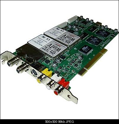

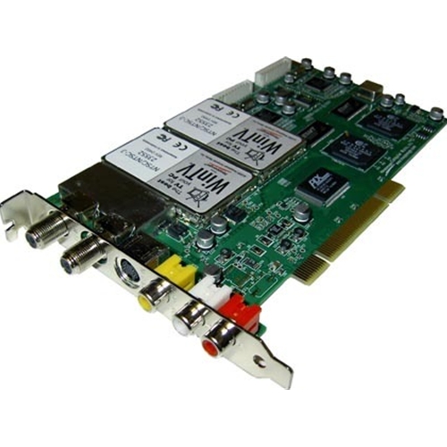

  24. The guys that answer you here are pretty knowledgeable people. I will just suggest as many to start from the root capturing better. You can also use VirtualVCR instead of VirtualDub ( i think it will support you card hauppage pvr 500 this one Click image for larger version
ID:	11743right ? )and capture in huffyuv ( or other lossless capturing codec like lagarith) that way your are very close to the source and no color conversation ( which can loose some details which are there) I guess you can also lower the sharpens on the picture it looks over sharped or I am tired and sleepy and don't see well .
    I like the master try especially the last one.
    As long as tbc is concern if you don't have vcr or dvd recorder ( as pass trough ) with tbc and don't want to spend any money, you can try some software version tries at doom9.org the guys there ( jmac is member also here )in recent times had very very good progress, which may help you with yours case.
