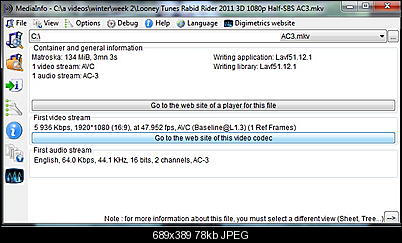

    this is the info i got wth the program. tv says not supported video codec.
    what is the best way to convert the video and is it possible

  6. That's a funky file, really funky. In every way possible: frame rate, audio frequency, audio sampling rate, AVC level 1.3, etc. Dunno who made it, and maybe it plays on his computer, but I wouldn't expect it to play on *any* TV. But maybe someone with a deeper knowledge of those parameters will comment.
    OTOH, I have a new LG 65LW6500 3D HDTV, and can confirm it will play properly encoded MKVs (i.e. made by myself) and transport streams containing AVC (H.264) video with AC3. From NTFS formatted USB thumb drives and external hard drives, no problem. But seeing as how you haven't told us the model number of your TV (is it a secret?), I'm just guessing the problem is the file.
