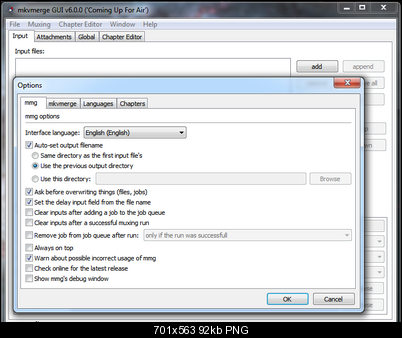

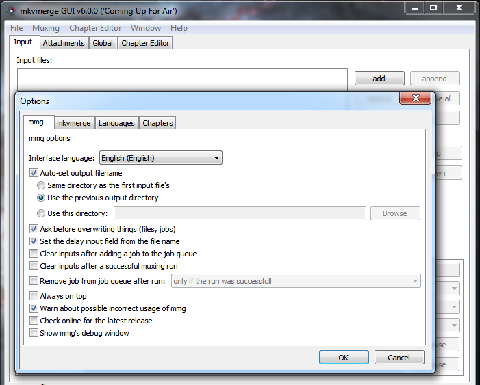

    the option to turn off/on header stripping is gone. it's currently off permanently as now there is no way to turn it on.

  17. Guess I'll have to stick with 5.8.0. But I'm not sure what you mean by " it's currently off permanently". The option in the old dialog was called "Disable Header Removal Compression..." so turning it "on" disabled Header Removal Compression (it was off by default). Are you saying all files muxed with the new version use Header Removal Compression? Could you upload a small file muxed with the new version? Or just show a MediaInfo report for a file muxed with it?

    header removal compression is now always removed if it was there, and can no longer be used.
    Wow, that's a surprise.
