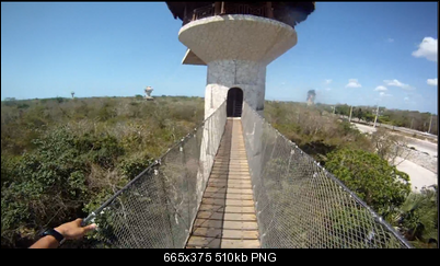

    I captured a HD clip from You Tube. The clip was saved as mp4 file. When I play the clip in the Windows Player the clip plays fine with out any distortions. When I play the same clip in Premiere there are a lot of pixelation. during motion.
    Here is the screen grab from Windows Player

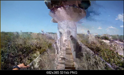

    However when I play the clip in Adobe Premiere there are a lot of distortions during movement. I assume some how Premiere's mp4 codec does not interprets the clip correctly.
    Here is the same screen grab from Premiere.
