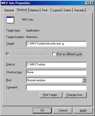

    MKVToolnix package has another tool, command line usually, but it has a hidden GUI.
    If you make a shortcut to it, then edit it like so;
    In the package MKVToolnix is a command line tool "mkvinfo.exe" that HAS a hidden GUI built in. To access the GUI use a "-g" at the command line or make a shortcut with;
    ...it should give all the specs of the file.
