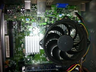

    Tracking down that Emachine PC model, (EL 1352G?) I am very surprised it doesn't appear to have a regular PCI slot. Looks to have only a PCI-e X16 and a PCI-e X1 slot. PCI-e X16 is usually for a video card. So looking for a X1 card on NewEgg, I found this one that should work. http://www.newegg.com/Product/Product.aspx?Item=N82E16815166018 I would still open the case first and check that the photo I put up is similar to your motherboard.
    You could check with Walmart to see if they have a PCI-e X1 card, but I doubt it.
    With Windows 7, it should autoconfigure.

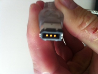

    here is a pic of my fw cord. Is it a 6 pin? I assume so, it has 3 copper colored things on each side as you can see.
    My mother board looks almost exactly like the pic you posted. Please confirm your above link is what I need to get from newegg. thanks for your help

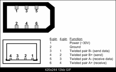

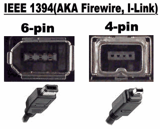

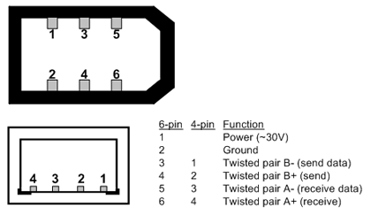

    Firewire plugs and jacks
