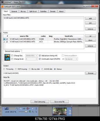

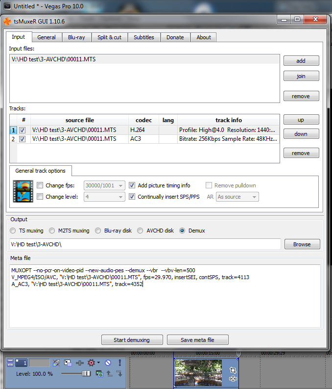

    I demuxed to elementary h.264 and ac3 streams as shown below.
    Vegas took the h.264 elementary stream but rejected the AC3 audio. Can the HD-PVR output audio as mp2 or wav?

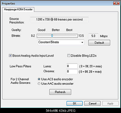

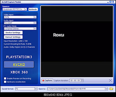

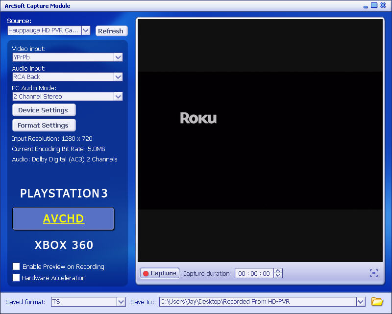

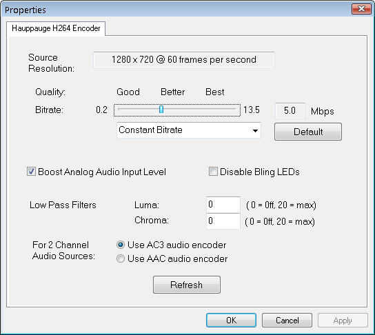

    Here's my settings:
    Try this, and if it still doesn't work, you need to install the K-Lite codec pack. http://www.codecguide.com/download_kl.htm.
    Do the "Standard" install, without the media player. Then restart Vegas and you're good to go. If you're using Win7 64 bit Vegas, you need to also install the 64 bit K-Lite pack. Both packs can live on the same machine, no problem.
    And in case somebody chimes in here that codec packs are evil, consider that they come from the most trusted people in the computer world. The Open Source Developers. They are absolutely safe if you don't dink around with them.
