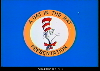

  5. OK, here's some empirical evidence. I dug an an old VHS deck out of the closet and captured a section of a tape (a commercial release, from the bargain bin many years ago) four times. I used a Panasonic ES15 in passthrough mode as a TBC. I used the following script:
    v1=AviSource("cap2.avi").Trim(16,0)
    v2=AviSource("cap3.avi").Trim(20,0)
    v3=AviSource("cap4.avi").Trim(24,0)
    v4=AviSource("cap5.avi").Trim(20,0)
    v12=Overlay(v1,v2,opacity=0.5)
    v34=Overlay(v3,v4,opacity=0.5)
    Overlay(v12,v34,opacity=0.5)
    Here's a frame from cap2.avi:
    Here's the same frame averaged over the four caps (the output of the above script):
    I picked this particular frame because it's easily identified by the white spot. Otherwise it's representative of the rest of the video. There is definitely less noise after averaging the four videos together. As expected, the white spot, being "on the tape" (and probably on the film it was made from), did not disappear.

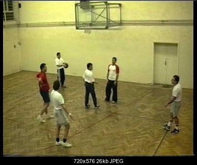

  22. I had spare time these weekend and i tried capturing from hi8 trough Panasonic dmr es15, i captured 4 copies made trim in virtual dub and virtual dub mod and 4 copies are now perfect match. The problem is when i load the script its says no overlay ( is it some dll or other involved)

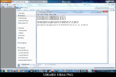

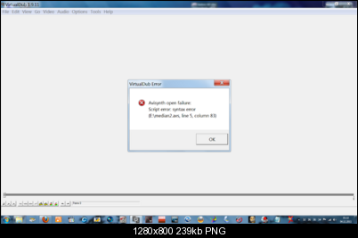

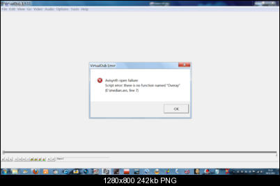

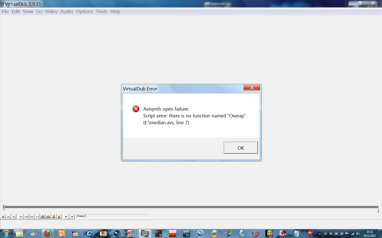

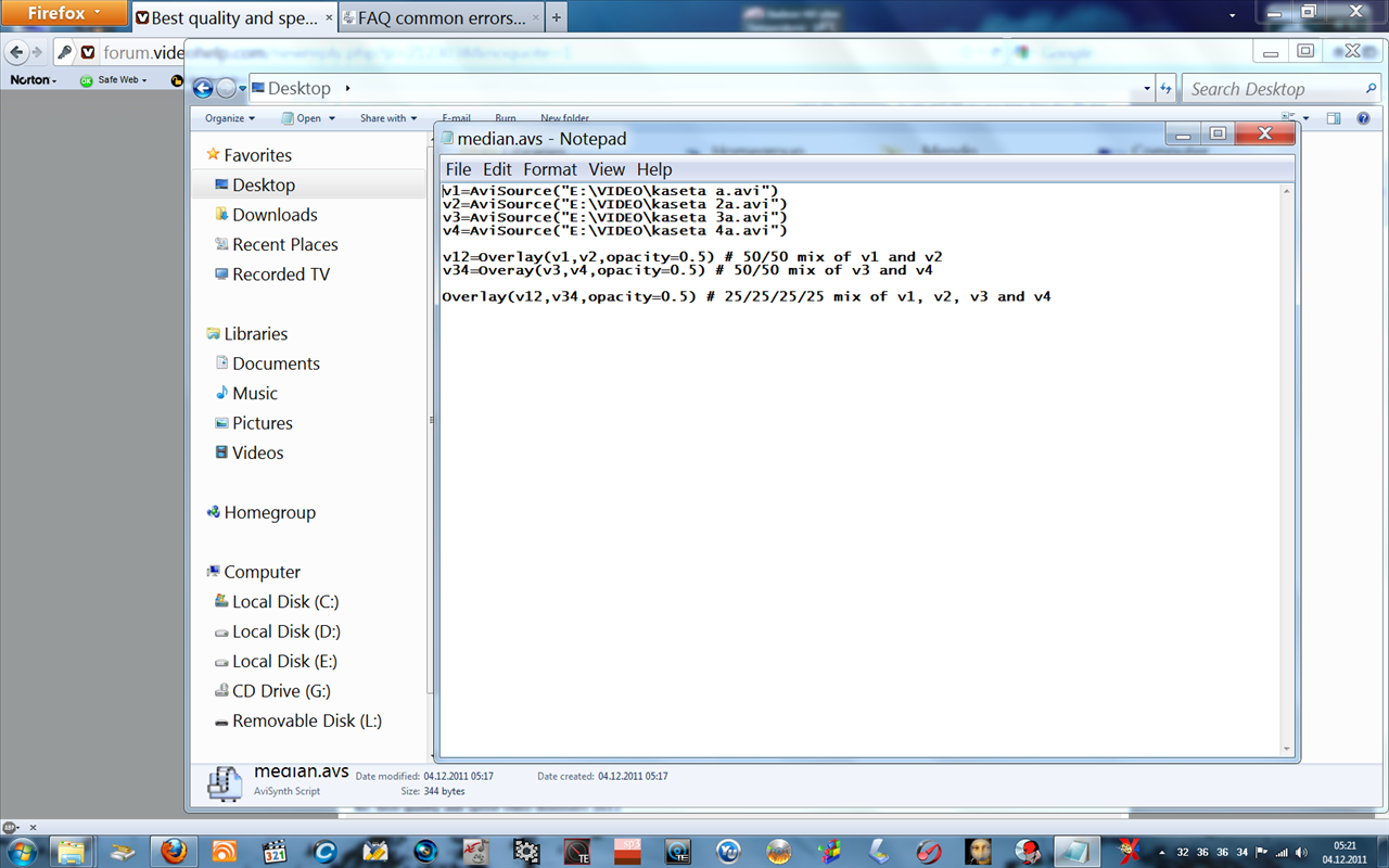

  23. I also tried jmac version of median it says syntax error.
  24. overlay is spelled incorrectly (missing a "l")
    v34=overay
  25. overlay is spelled incorrectly (missing a "l")
    v34=overay
    Thanks i didn't see that silly me i just copied from jagabo without thinking

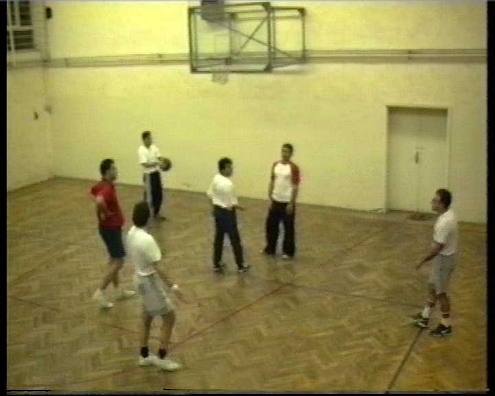

  26. I must say that there is definitely some noise reduction happening with this method( I was really skeptic). So if i understand it correctly i don't loose any information of the original picture with these ( unlike noise reduction plugins) right? Here is some examples
Name:	kaseta 3a_0.00.00.00.jpg
ID:	9927Click image for larger version
ID:	9928Click image for larger version
Name:	kaseta a_0.00.00.00.jpg
