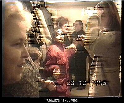

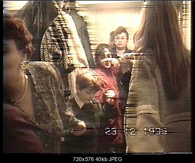

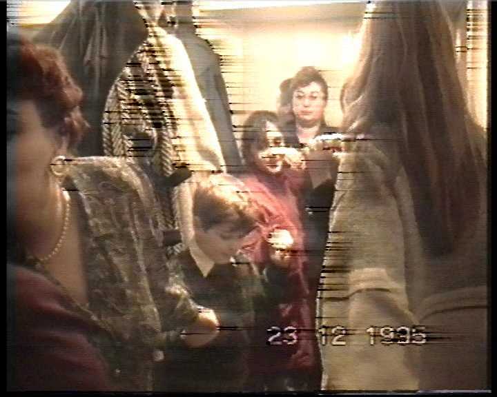

ID:	9241 Hi guys I finally tried to transfer hi8 tapes (8 of them ) to pc after long period of vhs tapes transfer (more than 100). I use Samsung My cam k60 8mm video camera, all the recordings were made on a Sony hi8 mm camera but its broken and I don't have it anymore. The problem is that on one of the tapes there is some kind of comet trails but black ( I saw somewhere white comets but these are black all over the place).Its the same if watched on TV or captured on pc.The problem is not the camera because I tried the other tapes and they all play well the tapes are not too old from around 1994-1995. Could someone direct to the right direction that I can solve this issue I don't have standalone tbc but I use Panasonic dmr es15 as a pass trough I feed the DVD recorder with composite in form the camera and from DVD recorder svideo out to the pc. I uploaded 18mb mjpeg file http://www.mediafire.com/?46cwom3csci685n so someone can look at it and here is the pictures of the problem.

  3. Member edDV's Avatar
    Mar 2004
    Northern California, USA
    Hi8 uses a different FM deviation vs. Video8. Therefore you can't play Hi8 in a Video8 camcorder but a Hi8 camcorder will play both.
    Otherwise, dirty heads or worn heads most likely. Try a different Hi8 camcorder.

  4. Hi8 uses a different FM deviation vs. Video8. Therefore you can't play Hi8 in a Video8 camcorder but a Hi8 camcorder will play both
    I understand that but all my tapes are recorded at same camera Sony hi8 and all of them play well no streaks or anything ( if the problem was the format then all the tapes would have it in the new camera Samsung one 8mm not only this one ) If it is bad head also the previous problem will apply on all tapes or I am missing something. The head is clean I opened and inspected there is no visible clog. The fanny thing is ( this happened to me before on a VHS tape https://forum.videohelp.com/threads/339642-Tbc-makes-bad-picture-worse ) that form let say all the length of the tape 90 min Sony anti static lid Hi8MP90 only 18 min has this kind of error and the rest is perfectly fine. Could be the time of the filming or something else I don't know. unfortunately I don't have the original camera anymore and I will try to use different camera if I can find one but i don't think that is the problem.

  6. Member edDV's Avatar
    Mar 2004
    So this is only one tape or part of a tape? It could be tape damage caused by heat exposure. Old tapes get sticky and shed oxide. The way to tell is play the tape in another camcorder and see if the problem follows the tape.

  7. Its only part of the tape that's why I'm confused if it is head or damaged tape would it be on the whole tape not just this part
  8. Dirty heads can be caused by particles you cannot see with the naked eye (microns in size).
    Thanks for the explanation, i didn't know that, but as I sad before it's only part of the tape and the rest is just perfectly fine and i had similar problem with the vhs tape ( only just 15 min was bad all else good )

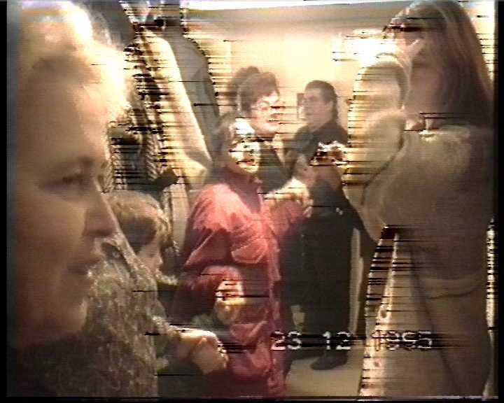

  10. That can be fixed with this script
    http://forum.doom9.org/showthread.php?t=121197&page=3
    Thanks jmac698 that's what I was looking for i will try this script tomorrow and will post the before and after pics, and let you know how it was

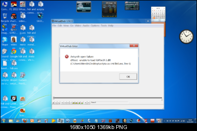

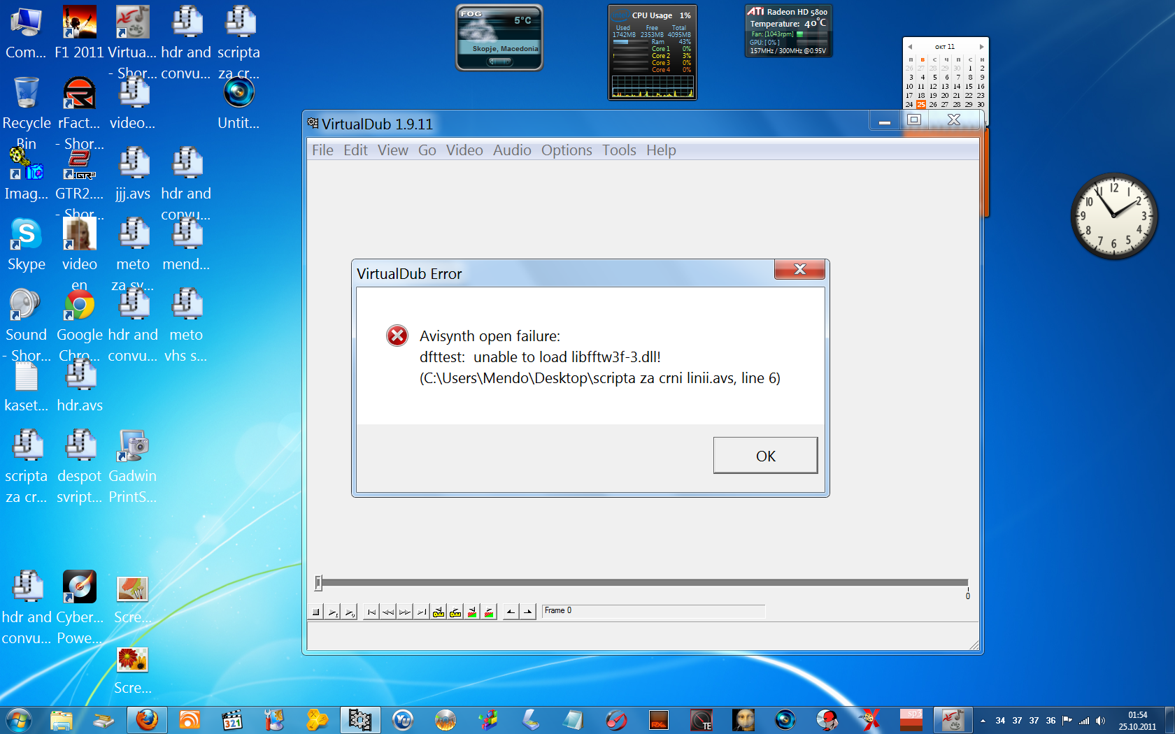

  19. Click image for larger version
    I assume that this script is calling some other script or some function but I'm dumb enough not to figure it out. I copied the script from the link that jmac698 posted

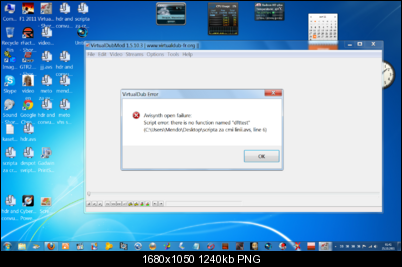

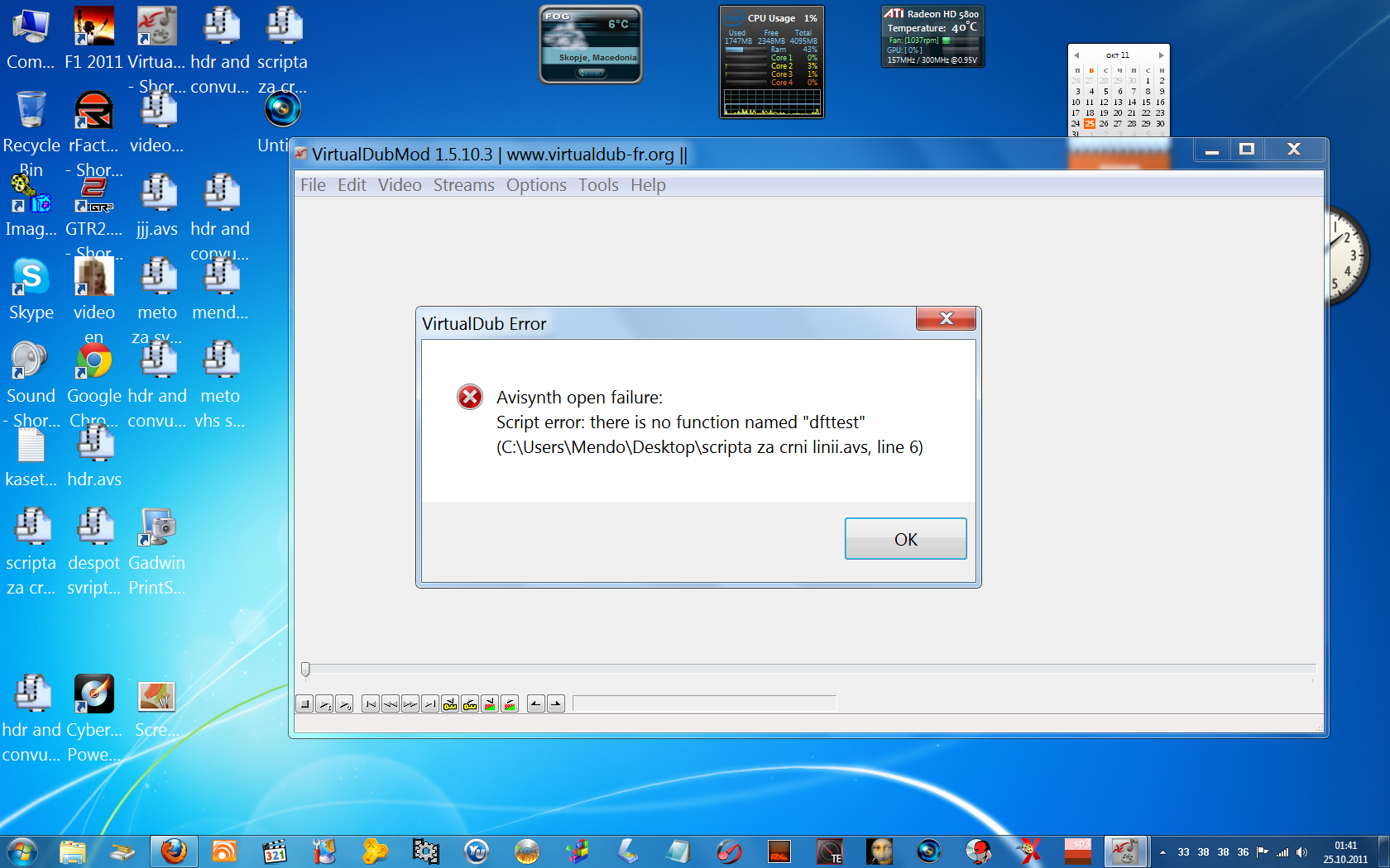

  20. "there is no function named "dfttest" " usually means you're missing dfttest
    download it , place the .dll in the plugins folder
    http://web.missouri.edu/~kes25c/
    If you can find something , use google for the filter name + avisynth as the search terms
    e.g. "avisynth dfttest" and that link will be the 1st hit
  21. Thanks poisondeathray i downloaded and put it in avisynth plugin folder 2 files that came with it now another problem

  24. place that dll in the system32 folder on x86 OS , in syswow64 folder on x64 OS
  25. Banned
    New York, US
    libfftw3f-3.dll comes with the dfttest zip package (re: the dfttest readme.txt file).
    Ed: See poisondeathray's post above this one, which I noticed just after I clicked on "Submit" for this message. Sorry.

    Oct 2010
    England
    Not necessarily. Does your Sony Hi8 have a switch or an option within the menu system to let you record in either 8mm(Video8) or Hi8 video formats? Some camcorders allow you to record in either format.
    You might have recorded most of your videos in regular Video8, but recorded this single tape in Hi8, which would explain the problems you're seeing.
    I used to see something similar with my recordings if I accidentally played back an S-VHS video in a regular VHS machine.
    This makes it even more likely that it's related to the recording format you chose, rather than a physical tape issue.
    Originally Posted by Rhymester View Post
    I have a tape which plays OK from the camera but looks exactly like your screen shots when I put the tape into the VCR adapter and play it on my VCR recorder. I am almost certain that it's simply a problem with the playback heads on the VCR.
    If the tape is S-VHS-C, and you're trying to play it back in a VHS machine with an adapter, it's likely to be a similar video format incompatibility.
    Try to find an S-VHS machine to play your tape.

    That script requires a different version of AviSynth ("MT").
  28. I can tell from looking at the script it needs these; mvtools, removegrain, masktools, dfttest. There is sometimes a problem with an error in clense; unfortunately there's two versions of clense, the older one will probably work. I updated the documentation under removegrain for this reason. http://avisynth.org/mediawiki/Removegrain
    I agree about the documentation, in fact I came up with a solution to this but no one was interested; a feature for AvsPMod (where presumbly some of these scripts were developed) which saves the list of used plugins along with the script; I then had a system using a software updater tool which could load all required plugins and the right versions. For my part I list requirements with my scripts.
  29. avisynth mt crashed all the time for, to use such an optimized script just remove all those setmtmode lines.
