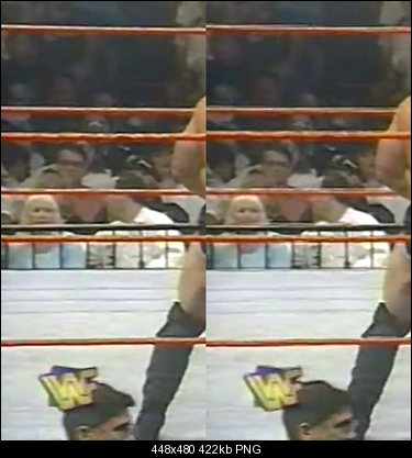

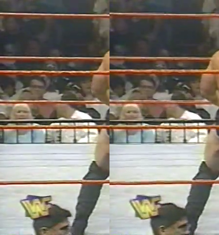

  14. I see aliasing artifacts on the ropes but I don't see any comb artifacts on the crowd. Like the right half of this image:
  15. Originally Posted by jagabo View Post
    [Attachment 9787 - Click to enlarge]
    Could you please tell me what Anti-aliasing script you used to fix the ropes?
  16. Originally Posted by holygamer View Post
    I didn't use any explicit antialiasing. I no longer have the video or the script. But I'm pretty sure I used QTGMC() which would performed some anti aliasing/smoothing. The sample image showed two different frames. One where the deinterlacing worked well, one where it didn't.
