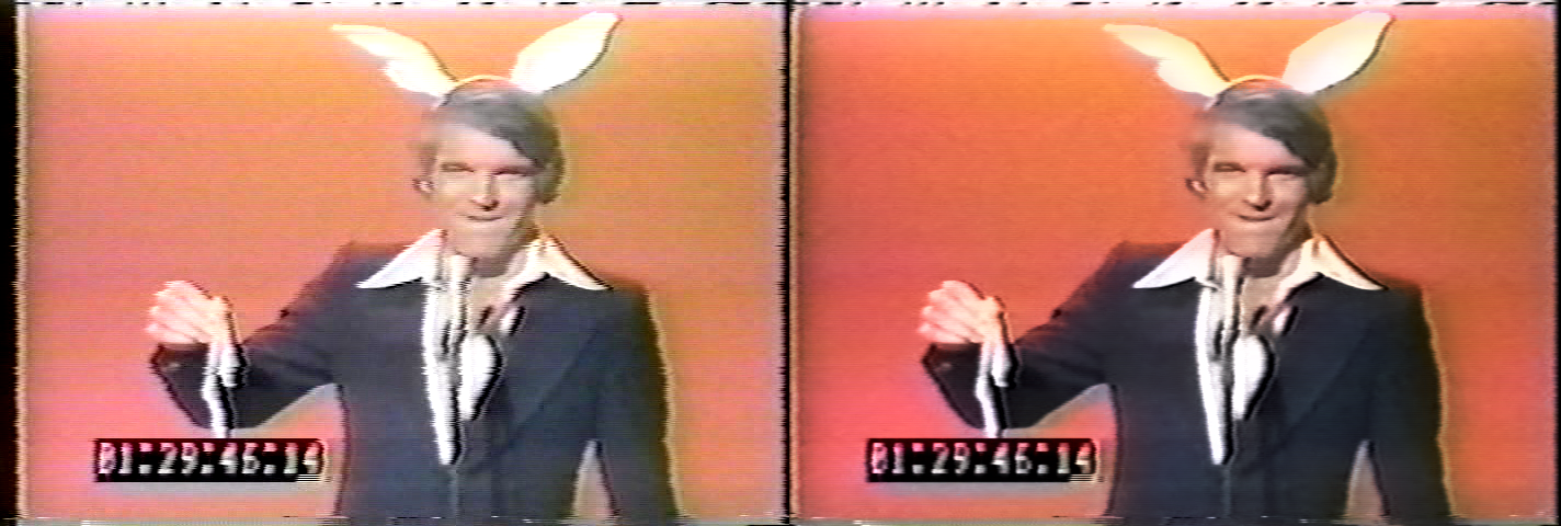

  11. Click image for larger version
    I also added deblocking to the Mpeg2Source line and used VirtualDub's Camcorder Denoise to remove some of the chroma noise and adjusted the gamma slightly. This video is extremely BRIGHT and it has blown away much of the detail. It is supposedly 2nd generation from the CBS master tape but it must have been dubbed poorly. It has not been aired in full since 1976...vh1 aired a 30 minute edited version years ago when "Believe" hit it big.
    I would like to thank jmac for his advances with this software TBC. Hopefully I can figure something out for the darker scenes as well

    Btw, how to average all frames in a clip, pixel by pixel?
  30. I'm not sure I'm following you exactly. Where do I come up with the number to replace "140" for different scenes? Csamp or...?
