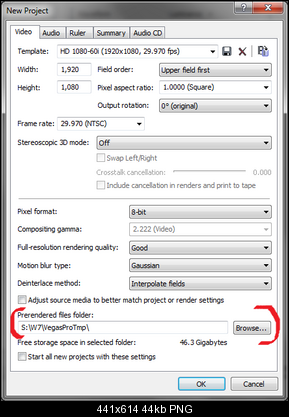

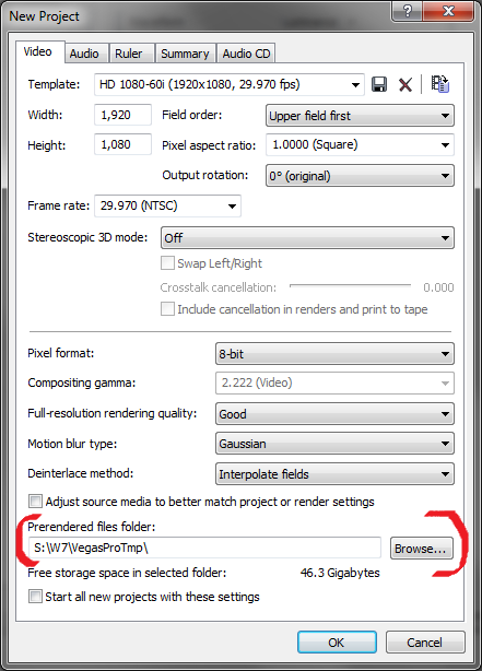

    I don't have access to a Vegas Movie Studio 10 here but this is where you set the "Prerendered files folder" in Vegas Pro. Adobe Premiere or Photoshop call this the "scratch disk". If possible, you don't want this on your OS drive.
    Last edited by edDV; 17th Aug 2011 at 01:36. Reason: Corrected swap disk to "scratch" disk

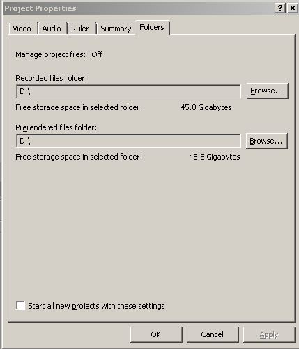

  4. edDV thatns a ton. That's what I was looking for. I remember that from Adobe Photoshop but I didn't know the analagous in VMS. I assume my issue is disk I/O, disk space or RAM issue. Anywy I switched the "Prerendered" location to a non-OS drive. Any other tips would be appreciated. Click image for larger version

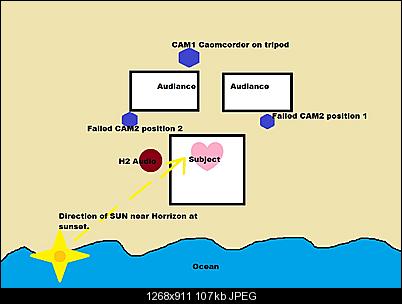

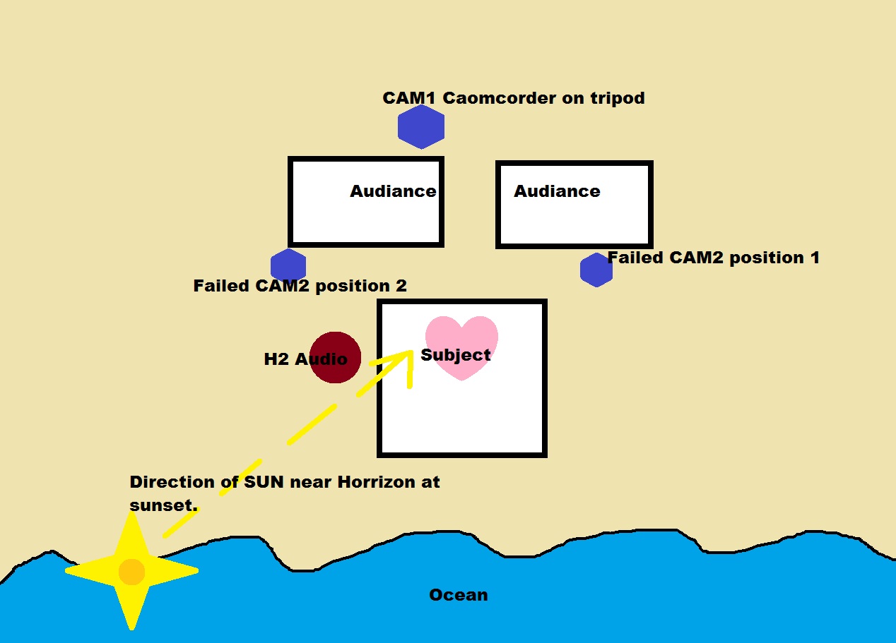

  10. Ya, multi cam is really fun. I've done it before. I was really upset when I realized the Nikon would not work for the shoot. It blew my whole game plan. I didn't set the Canon camcorder in the best spot for a single cam shoot. I have to do a boaring 1 cam shot of the wedding ceremony. I had 2 other lenses in the hotel room, but there was no time to get them.
    Here is a diagram of the shoot. I had to position CAM1 off center to avoid lens flare. The subjects were backlit. The planned cam2 positions are marked, but the camera was not functional.

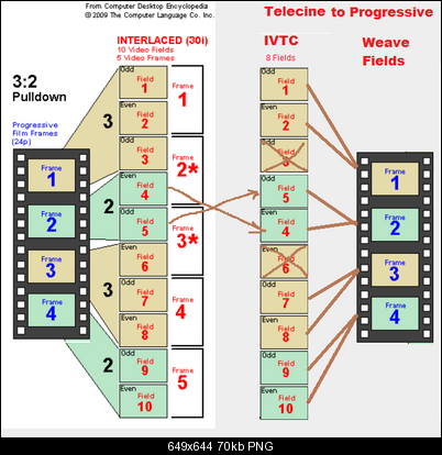

    I'll run media info on all the clip types. I get the general concept of telcine. In fact, I'm pretty sure it was your post that educated me. I was referring to some cameras that cheat and record "24p" in 60i. So basically the image is 60i with a bunch of repeated frames "telcine" and not real 24p.
    Telecine has repeated fields that are removed in the inverse telecine process to restore the original 23.976p.
    Normal telecine - inverse telecine looks like this. It is a lossless process if done correctly. There are variations such as so called 24F and 24pA.
    60i and 30i are the same thing. Actual field rate is 59.94.
    The white left half of this drawing is what your HF100 outputs in 24p mode.
    Originally Posted by magillagorilla View Post
    I very much understand interlace. I've been restoring VHS footage as another project. I am well versed in fields, frames, interlac, de-interlace. I am restoring my VHS to 60p using a smart bober. The target playback device being computer displays.
    That only works for native interlace source. That doesn't work for film (24 fps) based telecine source unless you insert a 2:3:2:3 frame repeat pattern. To do that you must first inverse telecine to 23.976. Separate subject... but you will need to do the same for a progressive DVD.
    My lack of patients is caused by my poor tools. I'm no pro but my skills exceed my tools. It's like turning a standard bolt with a metric wrench. It'll work, eventually.
    You use the method intended for your editor version which is most likely limited to 60i for AVCHD. If you force the editor into 24p mode, expect trouble. Test every step.
    My target formats are SD DVD (not AVCHD DVD) and a HD mp4 version for computer playback.
    A 23.976 project can be downsized for progressive DVD with good results. It can also be encoded directly to h.264 in mp4 container but probably not in your version of Vegas.
    A 60i project is converted to a 480i DVD. Vegas uses a simple deinterlace/downscale which is not the best for telecine source. Extenally you could inverse telecine before downscale for a better Progressive DVD result.
    If you spec a progressive DVD in Vegas, all frames will be interpolated 60i to 23.976p causing more quality loss.
