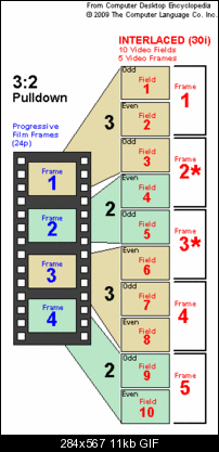

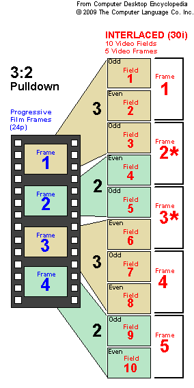

  17. I thought I read that before that Film is 24 FPS but I never undertand how that would work.
    I know you can shot Film at 24 fps and the Projector will show 24 fps but when they go to put it on TV I know they Up the Frame and then Down the Fram to 29.97 fps.
    But f you shot in 24 frame how do you up the Frame do they add copies of frames?
  18. You don't see 29.97 fps on interlaced TVs. You see 59.94 fields per second. 24 fps film is telecined by showing each film frame for 2 or 3 fields, alternating between the two. On average that's 2.5 fields per second. 24 * 2.5 = 60.
    In Europe and other PAL countries, where interlaced video is 50 fields per second, film is usually sped up to 25 fps (movies run about 4 percent shorter because of this) and each frame is displayed for 2 fields.
  19. Member edDV's Avatar
    Mar 2004
    Northern California, USA
    It is done by repeating fields, not full frames.
    Some homework required. Take it slow. It becomes clear 2nd or third read.

    Alternate view. 4 progressive film frames are converted to 5 29.97 fps (59.94 fields prer sec) video frames this way (aka telecine).
