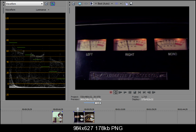

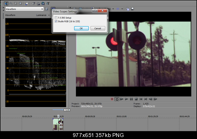

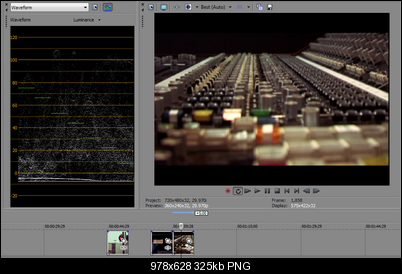

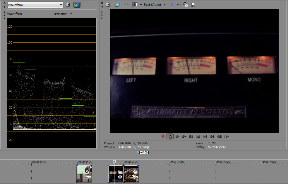

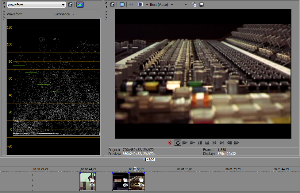

  14. Member edDV's Avatar
    Mar 2004
    Northern California, USA
    I'm not sure what the three attached VLC caps represent but the first looks like good 16-235 levels. The Vegas Pro scope is set for DV project format (zero=16 and 100=235).

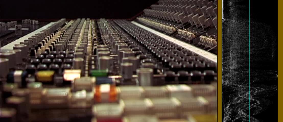

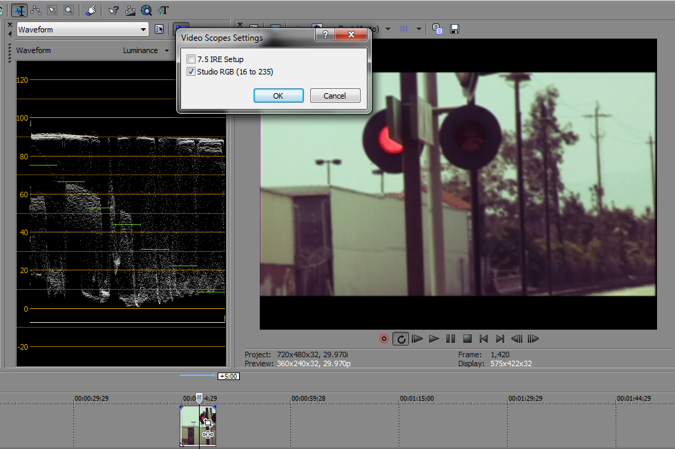

    The other two files show and expansion to 0-255. If encoded directly as is, these would show crushed blacks and possibly clipped whites.

  16. Member edDV's Avatar
    Mar 2004
    Originally Posted by Sullah View Post
    Thank you very much for doing this for me.
    If it was up to you would you select "the input video is RGB16-256" in your transcoder/encoder?
    I would go back to the editor and export YCbCr 16-235 (with overshoots).
    The two lower pictures are 0-255 RGB. If you select "16-256", you clip blacks at 16 (zero on the scope). This would crush your blacks.
    http://www.kiva.org/about

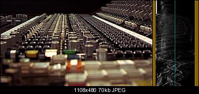

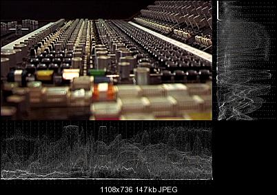

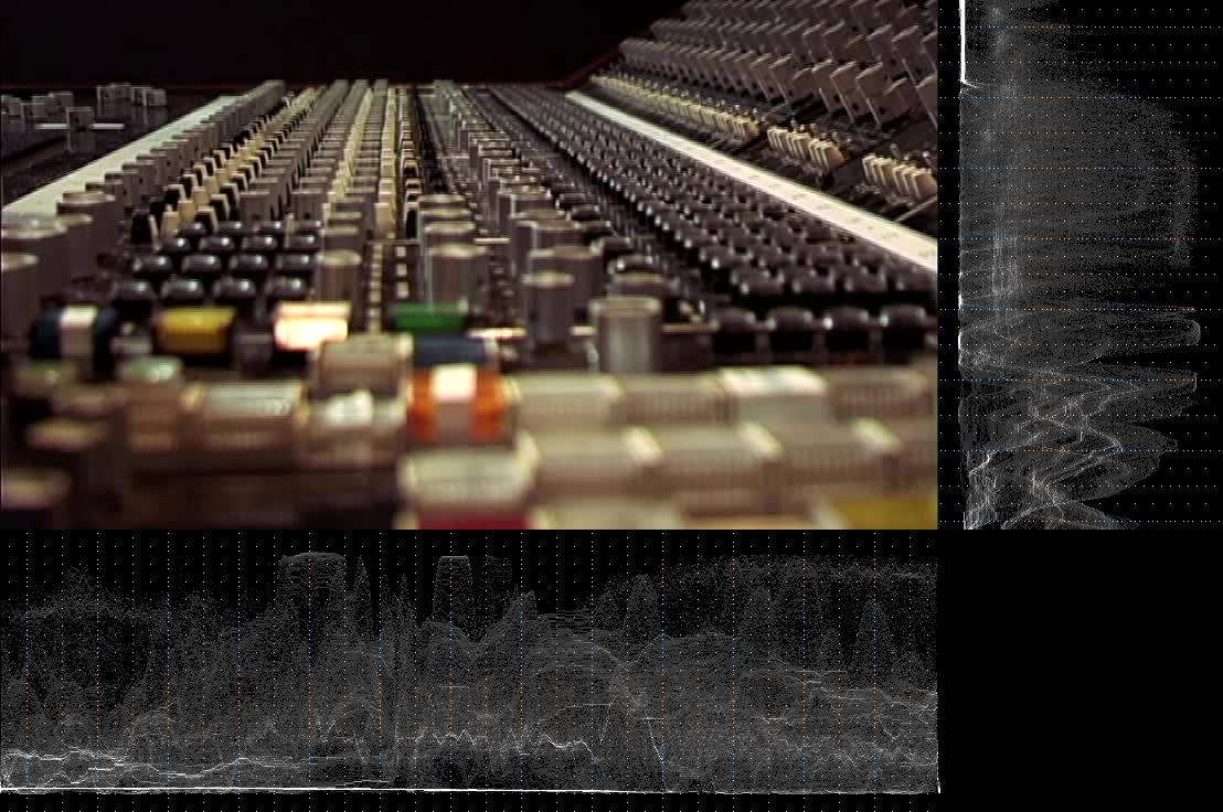

  20. If your editor doesn't have a luma graph feature you can use AviSynth:
    AviSource("filename.avi")
    Histogram()
    VideoScope()
    Histogram() is a little easier to read because it marks the super-black and super-white areas of the graph with brownish bars. If you would rather have the traditional horizontal graph use TurnRight().Histogram().TurnLeft(). That will give you a horizontal graph at the top of the frame.
    For these sample images I opened your JPG file and converted the RGB data back to YUV using a rec.601 matrix so we shouldn't see anything in the illegal areas. That doesn't mean your original source didn't have anything in those areas because we don't know for sure how your source YUV video was converted to RGB for the JPG images.
