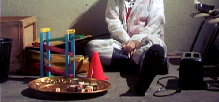

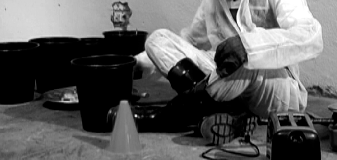

    This only happens with Procoder 3, no other encoder that was tested yielded the same result.
    Does anyone know what this is and how to fix it?
    I thought it was chroma subsempling http://en.wikipedia.org/wiki/Chroma_subsampling but apparently it s not.
    I have attached two snapshots. The problem in this frames is visible on the ORANGE CONE.
    The source is miniDV shot on the DVX100, exported from Avid using Avid DV codec (DV25)
    Encoding in Cinema Craft SP3, Sorenson 6 and DVD Flick did not cause this issue but the overall outcome is much better in Procoder aside from this issue so I would love to solve it and keep using Procoder.
    Thank you for looking into this.

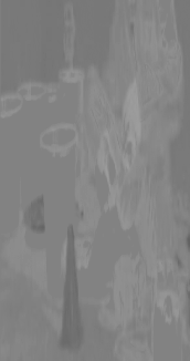

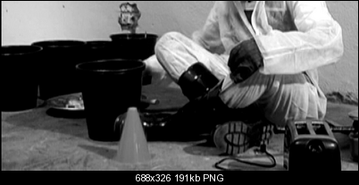

  2. 4:1:1 YUV is being upsampled to 4:4:4 RGB incorrectly. In a DV frame the Y (luma) channel is stored at the full frame width but the U and V (chroma) channels are stored at 1/4 the width of the frame.
    Y plane:

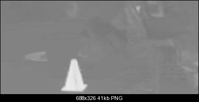

    U and V planes:
Size:  25.9 KB Name:  V.png

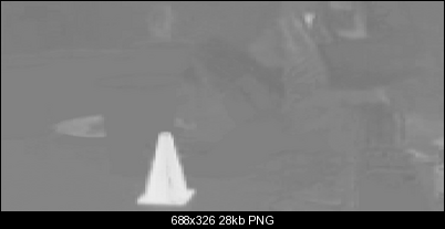

    The U and V planes are being stretched to the full frame width incorrectly. Probably with a point resize rather than a smooth resize.
    V plane upscaled with a point resize:

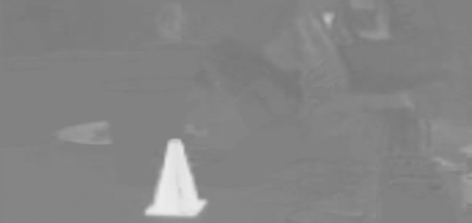

    V plane upscaled with a bicubic resize:
    Use a different DV decoder if possible.

  4. I added more details to my last post. I don't know if Procoder has its own built in DV decoder or if it is using a system installed (VFW or DirectShow) DV decoder. If it's using an installed DV decoder you can just use a different DV decoder (for example, ffdshow has the problem described, Cedocida doesn't).
    From a little searching, it looks like Procoder uses the system installed DV decoder. Just disable, or deprecate, that decoder and install another. You can use a filter editor to change decoder preferences.
