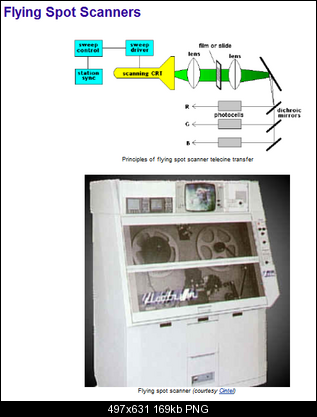

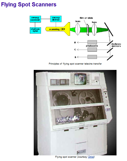

    The movie was shot with 35mm Panaflex cameras using Kodak Eastmancolor ECN-2 negative film.
    Normally the original negative is transferred to video via flying spot scanner (e.g. Rank Cintel) but if unavailable, a distribution positive print can be scanned. The scratch was on the film.
    http://www.danalee.ca/ttt/film_for_television.htm
    http://en.wikipedia.org/wiki/Spirit_DataCine

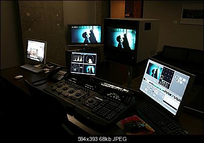

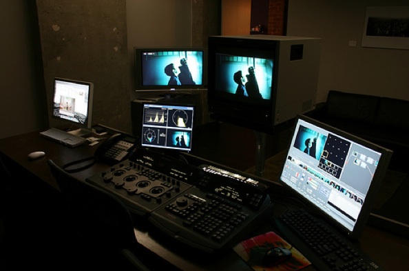

    Devices like the Snell Archangel Ph.C process the image in either auto or manual assist modes but in almost all cases color grading (correction) is done by a human specialist using a device like the Davinci Resolve.
    http://en.wikipedia.org/wiki/Color_grading
