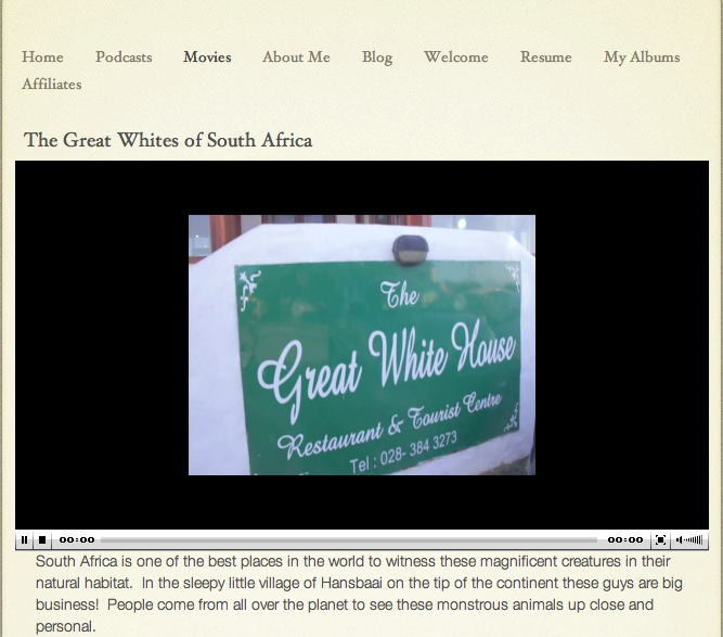

    This is a stumper and I could really use a freah perspective on it.
    I have been trying to get a Flash movie on my iWeb site bu using the instructions on the iWebUnlimited site here...
    http://iwebunlimited.com/iweb-tips/iweb-tip-9-flash-video-in-iweb-jw-player/
    The problem I have is that when I publish my changes in iWeb and point my browser to the page the movie is on, the movie plays as a litttle squashed box in the middle of the player. Let me explain...
    I followed the instructions on the iWebUnlimited site to the letter. I have downloaded the .swf and .js files, placed them in a folder called "flash" on my iDisk as well as my .flv movie file and a screengrab of the same size.
    I have changed all the parameters in the HTML code to point to my iDisk and the relavent files.
    I have changed the video dimensions to that of my newly encoded .flv video (640 x 352 - in ffmpegx)
    When I go to my movie page in my browser, I see the still shot I took as a place marker in the right dimensions. Yet when I play the movie, although the player is the size I requested - 640 x 352 - the actual movie plays inside it as a squashed box. Take a look at the screenshot attached to see what I mean.
    The video should fill the black areas, but whatever I do this is the result...
    The weird thing is - I uploaded a flash movie a couple of years ago to the same page and it plays ok - looks fine. Shame I can't remember how the Hell I did it! I wondered if having 2 flash movies on the same page were causing the problem, so I deleted the old one.

    So I now have my full length .flv movie at my 640 x 352 on my iDisk with iWeb pointing at it and the correct dimensions input in the HTML code, and it STILL comes out squashed when viewed in my browser....
    if anyone has a clue what is causing this or what I am doing wrong, I will be forever in your debt! My ffmpegx settings were .flv, 1500kbps, to fit onto 1 x DVD at 4GB, 16:9, 640 x 352, Pal 25fps, High Quality and 2 pass both checked...

Name:	Squashed Video.png
    The smaller video area is 320x240, which is the old default size for FLV video. This makes me think that perhaps your FLV file does not have any meta data embedded to let the JW Player know the true size.
    Did you install the flvtool for ffmpegX? This post-processing tool injects meta data into an FLV file, which web players can read and use, before any movie decoding gets done. [When most web videos were 320x240, many users wanted the meta data so that the player knows the duration, and thus provide more functionality on the play bar at the bottom (remaining time on the right side and skip to a time by moving the play point on the slider).]
