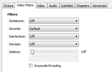

  6. Member edDV's Avatar
    Mar 2004
    Northern California, USA
    Originally Posted by nymph4444 View Post
    I whent to the link you gave to Hanbrake and read about Decomb
    It says that if a video need De Interlace it will do it.
    So I think I will leave it on all the time.
    And they do tell you what the diferance it between De Interlace and Decomb.
    But I could not get it.
    It says something about Decomb only does De Interlace if it needs it but the De Interlaceer will do it to every frame and loos picture Q.
    Or do I have this mixd up can you explane it?
    That is what they say. It looks like a crude way to go about it. It may be good enough for you but to do it correctly you need to examine the source for telecine pattern. If yes, use "Detelecine", if no you have three choices in Handbrake.
    Weave - all filters set off. It will also apply a weave to hard telecine or progressive source.
    Deinterlace - choice of fast, slow, slower
    Decomb - see manual
    Missing in handbrake is the output interlace option that I hoped was there. I'm looking for an alternate x264 GUI that passes interlace from source (aka x264 MBAFF mode).

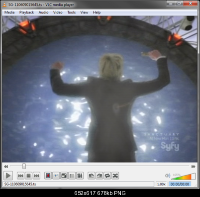

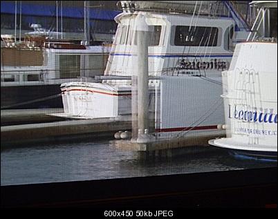

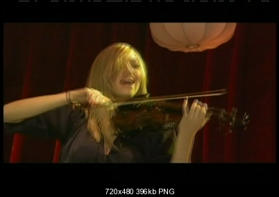

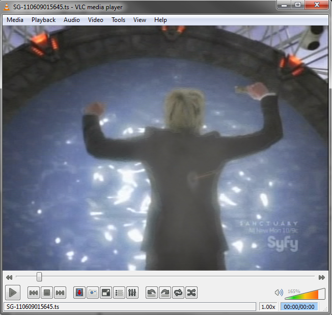

  15. Member edDV's Avatar
    Mar 2004
    I just read you reply to me about if I set de interlace to OFF and you told me it will then do a weave deinterlace
    What is this?

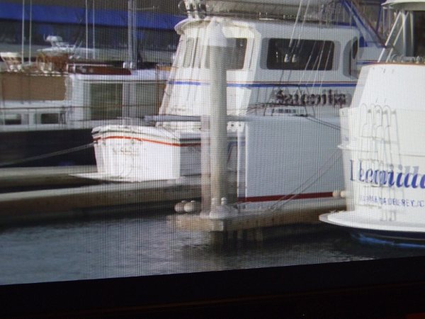

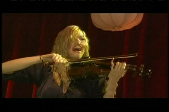

    Weave is a simple combination of field 1 and field 2 like Jagabo showed. If the source is interlace like "Land of the Lost" you will get line split during motion like this...
Size:  7.0 KB...Click image for larger version

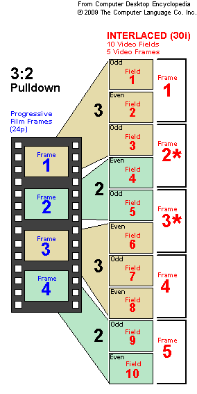

    Telecine video would show three progressive frames followed by two split field frames (double image) like this
    Notice the difference? Split lines vs. double vision fields?
    This is how you tell if your source is standard 59.94 field per second interlace (line split) vs. telecine (field split on two frames followed by three progressive frames).
    You can encode either permanently into your 480 29.97p or deal with them before encoding. You fix line split with deinterlace. You fix split fields with inverse telecine. Deinterlace results in 480 29.97p, inverse telecine results in 480 23.976p suitable for progressive DVD.

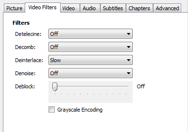

  16. OK so it will do me better to pick a De Interlace option from the dropdown list then set it to OFF.
    What would be a good option to pick SLOW?
    I mean for a show like Land Of The Lost that is Interlaced.
    And I re Read about Detelecene and I get it now if they take Film at 24 fps and put it on TV at 29.97 fps the frame rate will not match so they have to ad frames.
    If it is Hard Telecene they Copy frames and put them in.
    If it is Soft Telecene they just use Flags that tell the DVD or Video or whatever to show a frame longer.
    I would like Soft but Handbrake just has Costum Default OFF
    What do I use?
    I know this is just used if I have something that is Filmed.

  18. Member edDV's Avatar
    Mar 2004
    It would be better to keep it interlaced but Handbreak can't do that. I'm looking for other free alternatives. Sony Vegas Movie Studio 10 Platinum (~$70) offers two AVC codecs that will do interlace h.264.
    http://www.amazon.com/Sony-Vegas-Movie-Studio-Platinum/dp/B003L51CZ8/ref=sr_1_1?ie=UTF...7561682&sr=8-1
    Best you can do in Handbreak is deinterlace for "Land of the Lost". "Slower" would be the highest quality setting but also take the longest time. Test slow and slower on a scene with action.
    You will also be testing bit rate. I suggest you start with constant quality=20, then try 500Kbps that you want and compare on your computer, media player and TV.
    So in summary, your 720x480 60i MPeg2 VOB will be converted to 720x480 30p (29.97p actually) h.264.
    back later on telecine...

    Meanwhile I suggest you encode "Land of the Lost" with Handbrake and test deinterlace and various bit rate results on your displays. Learn one program. Then you can transfer your experience to others.
    http://www.kiva.org/about
  23. Member edDV's Avatar
    Mar 2004
    I can set Decomb to Auto and it will ony De Interlace if it see it has to. So with this type of show it will see it does not have to and wont.
    But the other De Interlace dropdown box you can't turn off so what do I do?
    Do you get me now?
    Yes you can turn it off.
    If you want to test Decomb first go ahead. Then you can compare that to Deinterlace later.

    So, did you try to decomb or deinterlace "Land of the Lost"?
    That is before we proceed to telecine?
    Decomb
    Deinterlace

    Remember this? You need to understand this chart. This is how 4 film frames are converted to 10 "hard telecined" video fields (5 video frames).
    [Attachment 7279 - Click to enlarge]

  28. Member edDV's Avatar
    Mar 2004
    Hard telecine means the video is stored on the DVD as interlace video with the repeat fields present. If you advance the video one frame at a time (say in Virtualdub*) during a scene with motion, you will see a sequence of three complete film frames then two mixed frames where the two fields are from different film frames.
    Soft telecine means the film frames are split into fields and stored on the DVD disc as two fields per film frame. This type of DVD is called "progressive" because when the two film fields are weaved, the result is a progressive frame. When a progressive DVD is played with the player set to 480i (composite, S-Video analog component or HDMI out), the fields are read off the DVD as a telecine field sequence at 59.94 fields per second (29.97 fps). When a progressive DVD is played with the player set to 480p (analog component or HDMI out), the film frames are played in a two then three frame repeat sequence at 59.94 frames per second. If you advance the video one frame at a time (say in Virtualdub*), you will see a sequence of progressive frames with no split fields.
    *Virtualdub must have access to an MPeg2 codec. You can also play a VOB directly in VLC with single frame advance using the frame advance button (see this thread https://forum.videohelp.com/threads/335478-VLC-how-to-view-final-frame). You might think you could inspect telecine fields on your DVD player but instead most DVD players will inverse telecine to prevent you from seeing the split fields.
    The VLC frame advance button allows stepping through hard telecine patterns. The frame shown is from Stargate.
