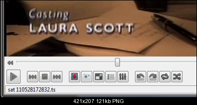

  4. Member edDV's Avatar
    Mar 2004
    Northern California, USA
    Open 'Advanced Controls' from the 'View' menu and a frame-by-frame button appears (down-arrow inside a film frame). Just click that from pause to play each frame.
    You can also use "custom interface" under "view" to add the "frame by frame" button to the lower line. I also moved "snapshot" there. Also keyboard Shift+> or Shift+< moves about 3 second steps. These work with MPeg as well.
    The "frame by frame" button works great for identifying telecine or frame repeat patterns.
