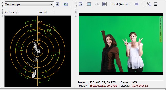

    I'd recommend you buy a chromakey optimized green screen from a video products seller or buy the Rosco chroma Key green paint.
    http://www.bhphotovideo.com/c/product/90460-REG/Rosco_150057110128_Chroma_Key_Paint_Green.html
    The idea is to get a single tight green dot on the vector scope, not a range of color blob. The tighter the Cb,Cr dot, the better the key, even if luminance varies.
    A fabric store Green may in fact be multi-colored when viewed on the vectorscope.
    Green is used because Rec 601 video has more detail in green. Blue is the worst and red is bad for keying humans. Single sensor cameras have many more green samples than red or blue in the Bayer pattern.
    DV cams suffer from 4:1:1 sampling. The color pixels can be blocky (too sharp) on key edges. This can often be improved by capturing analog S-Video for the foreground camera to soften the edge.
    Pros get great keys using RGB cameras or film. In those cases, blue screen can be used.

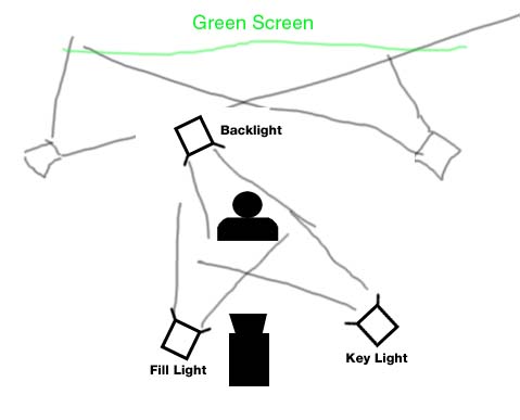

    This has all been discussed before. Ideal chroma key lighting puts some distance between green background and the talent to prevent green reflections on the talent. You want flat lighting on the background. Use your vector scope to control the green blob.
    Note the green blob on the vectorscope. The tighter the dot, (e.g. Rosco paint) the easier it will be to key.

    Now I'm looking for lights! lol. I went to Menard's and looked at their lights.
    EdDV - is that three lights in your diagram or five?

    Ideally five.
