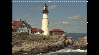

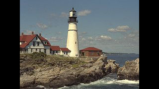

    Thanks for the reply, extended explanation and time saver tip much appreciated I will use some time to try it out and to fully understand it. I did try to import one file to vegas and opened properties on the clip i made a image to show the details (gif.1)
    The next image (jpeg) is from the preview option in vegas and also the same preview i get from DVD Architect when i import a rendered file changed in vegas, but i am not sure if the DVD will still show with black bars on the left and right side as well when showed on a widescreen tv and i cant really test it atm.

    the source you pictured is 4:3 pal. if you render it to 4:3 pal mpeg-2 for dvd there will be no bars at all.

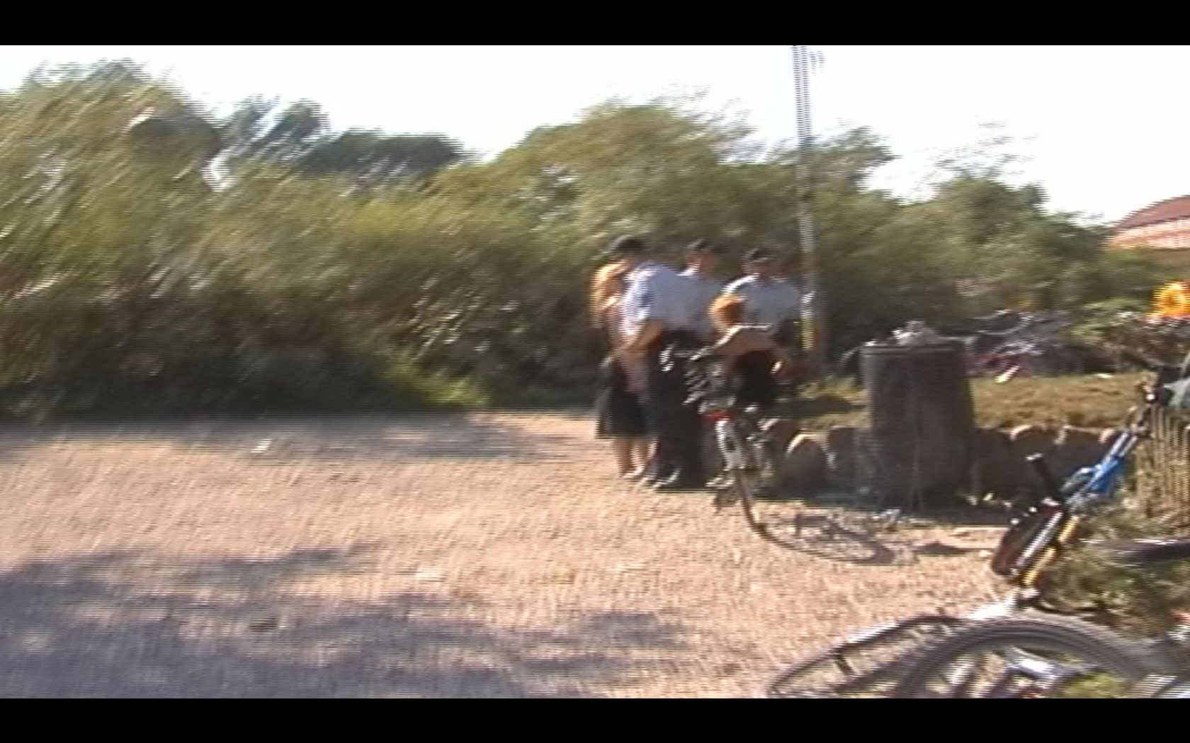

    I tried to render out a raw DV file i imported to vegas and the result was a MPG2 file for the that was only 5-10 mb size but i will still try it on the tv but doubt it works.
    But if the PAL DV file has 576 lines (720x576x24) can that be used for widescreen as the resolution is higher then the NTSC version which is 480 lines (720x480; 29,970 fps) ?

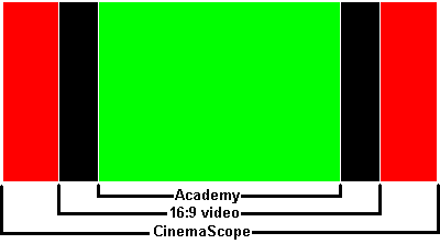

    You aren't going to fool a film school into thinking your 4:3 material was shot 16:9. Unless you framed for 16:9 while shooting 4:3 (e.g. tape strip top and bottom on viewfinder LCD), "conversion to 16:9" is going to have obvious artifacts and framing problems. A film school will respect 4:3 with side bars on a wide display because that is how 4:3 is supposed to be presented*. They will consider a hacked or stretched 16:9 conversion to be an insult. A sudden change in pixel aspect ratio (horizontal stretch) is as unacceptable as a jump cut.
    http://www.thelooniverse.com/movies/west/aspectratio/aspectratio.html
