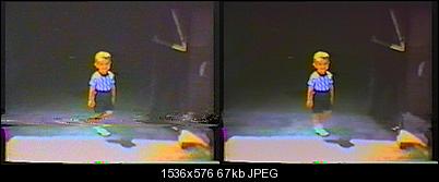

    Are you talking about something like this?
    I have an old video with a lot of "tracking"(among others) problems, and i keep coming again to it, over and over... and never found a acceptable outcome.

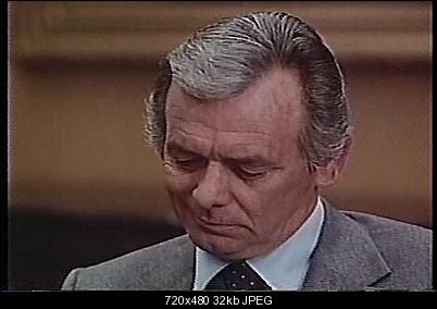

    This would be the goal to get the picture to look like page 2 of your thread...
    If this can be done in software that would be great....
    Yea it could be a single frame that is damaged, however what happens when it is like 4 to 10 frames where the tracking scrolls thru the video.
    Kind of read thru that post and it states that sometimes u get more details removed. To make this easy just compile the bad scene in the video. Run it through the scripts and than put it back in.
    Maybe that is an idea. Never really used scripting.....
    Wanted to use remove dirt on a few videos however couldn't get the scripts to install and run in virtual dub, kept getting error messages. Sent the video off to someone who has it installed correct. The problem on that tape was more of oxide drop outs in the video. The end product turned out a lot better than the source.

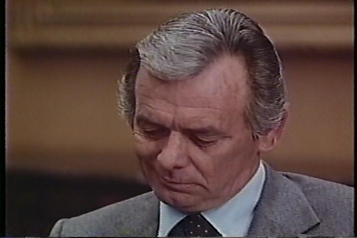

    Even if this frame per say doesn't blend in to the video, u can than edit in a photo program and blur out the scan lines or u can even replace the pixels.
    This example seems to be acceptable......U can kind of see the tracking in this picture but from the org picture the restored frame looks pretty good.

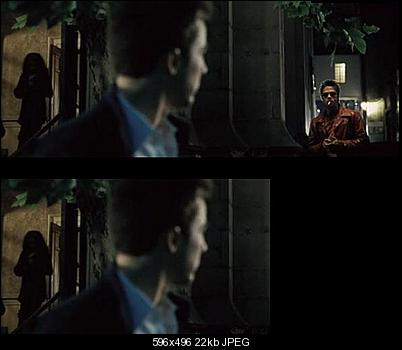

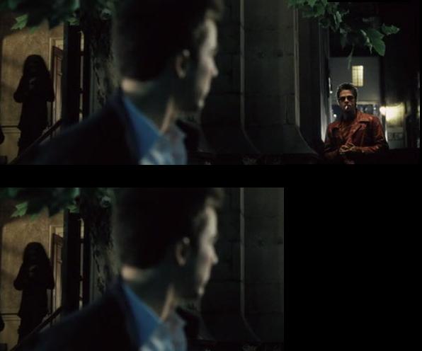

    We will use the movie Fight Club for this example...Don't have a copy of this movie but have seen it and actually looked for these inserts in the film. They are basically 1 frame flashes, all over the movie....
    What u do is this, don't have a copy of this movie again, if u want to upload this clip, I will go in a pull brad pitt out of the video.....
    It is this simple. You take the frame and take the last frame and pull Brad Pitt by cutting the picture....U than paste back, the last scene and he is gone...
    It is a little more advanced when u have to go in a re-paint the scene but the concept is the same.
    Or u pull that frame out of the video, and see if u can't pick up that it is gone, or blend the video to not be able to tell that he was in the video. Lets say Brad is in this scene for 10 frames and u want him gone....That is a little bit harder to deal with.....

    Thanks filmboss80, i saw that thread before, and its a logical and doable solution/fix, except my video is probably "re-recorded" with the tracking problem included, its a 3 generation video, so i cant adjust the tracking( i tried with several vcr-s).
    Deter, im not really complaining/arguing so please don't take it to your hart , maybe i didn't understood what kind of restoration you are talking about, i have tried editing frame by frame and it can give great results, but 25p video= 1500 frames in a minute(25i=3000/minute), so editing it frame by frame its...!?!?!
    And again, with this example with "fight club".. i understand the concept, and i have done it for some other reasons(inserting me in a movie) on a good looking video, but it almost has nothing to do with fixing tracking issues.
    Its easy to fix some occasional "tracking line" that its not really a tracking issue.. in a couple of frames, but usually tracking is present in most of the video, not just a couple of frames.

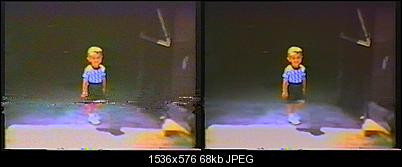

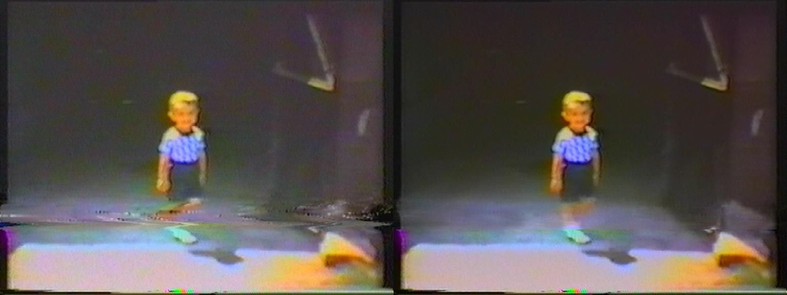

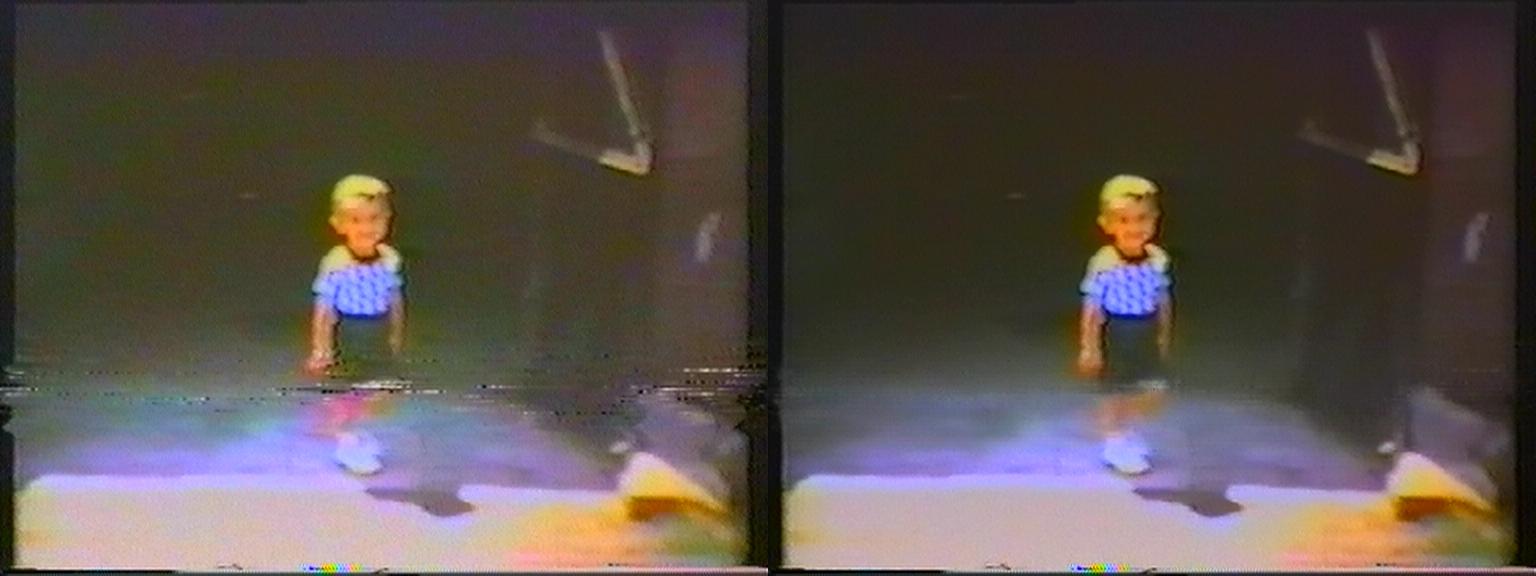

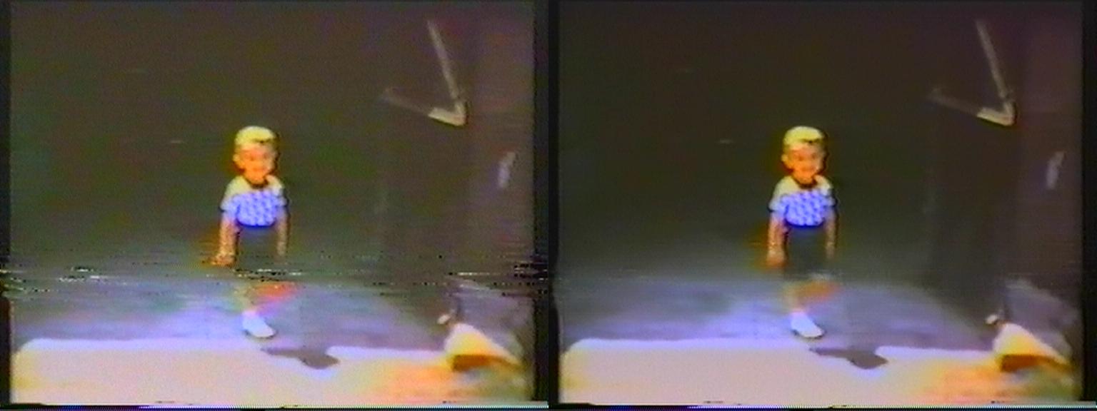

    I got some interesting result with a sample with REALLY bad tracking problems.
ID:	4663Click image for larger version
ID:	4662Click image for larger version
    i used
    AVISource("C:\test.avi")
    AssumeTFF()
    SeparateFields()
    TurnLeft()
    DeScratch(mindif=1, maxgap=20, minlen=2, blurlen=15, keep=2, border=0, maxangle=0)
    DeSpot(interlaced=false,p1=20,p2=12,pwidth=768,pheight=576,mthres=80,merode=33,sign=0,show=0,seg=0,color=true,motpn=true)
    TurnRight()
    Weave()
    Then i denoised it with MVDegrainMulti, then i crop-it and overlay-it over the (denoised with smdegrain)original test clip+levels
    edit: this is 3-th generation copy from 1973
    The restoration is 'way too red. Looks weird.
