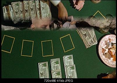

  2. If you can get an AIC codec for Windows it could easily be done with AviSynth. Crop() part of one video and Overlay() it over the other. You may have to adjust for brightness or color differences due to automatic gain during capture.
    v1 = DirectShowSource("video1.ext").Crop(0, 96, -0, 48) #leave just the good part
    v2 = DirectShowSource("video2.ext")
    Overlay(v2, v1, 0, 96) #overlay the good part of v1 over v2

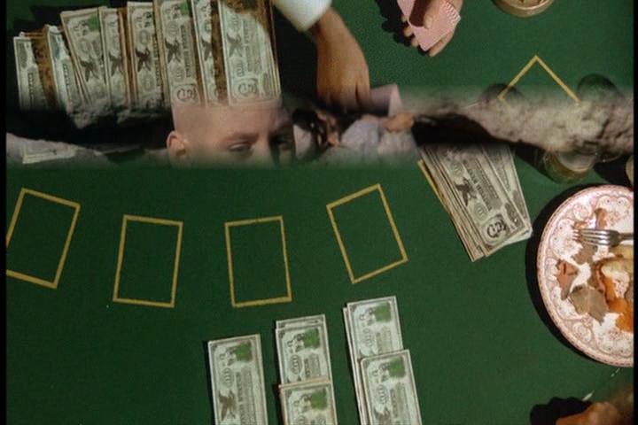

    Here's a sample of the result using two different videos (so it's obvious what's overlaid):

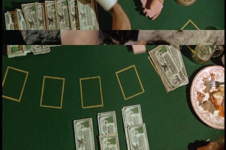

    Overlay() supports an alpha mask so if you can't get a perfect color match you can soften the transition with an alpha mask:
  6. Originally Posted by jagabo View Post
    Works great! I hadn't used avisynth in years (2004?) since I switched primarily to Mac back then. I had forgotten how powerful it is! Thanks Again!

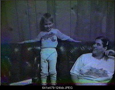

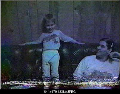

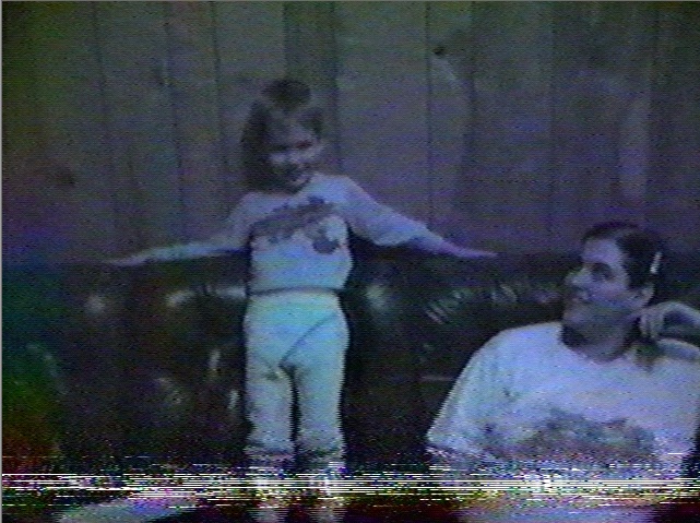

    Source 1 - Large Line of Static in Lower Half

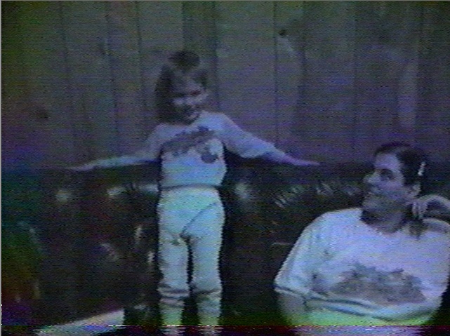

    Source2 - Line Moved with Head Tracking - Notice the Grainy Top Half and Discoloration at the Bottom

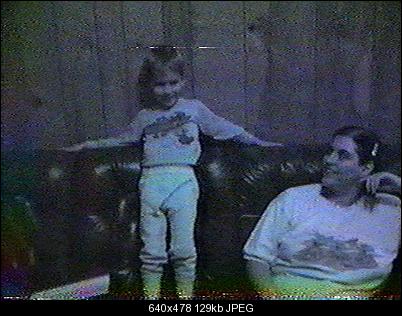

    Quick and Dirty Overlay - Needs Work
  9. Even the quick hack looks pretty good!
