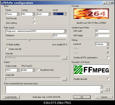

  12. x264vfw will be easier for you to use since it has presets to choose from.

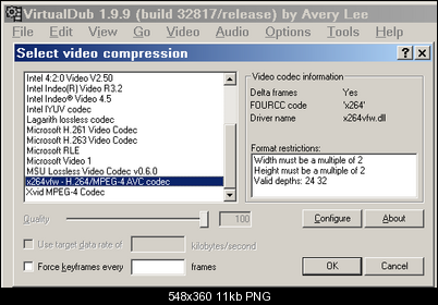

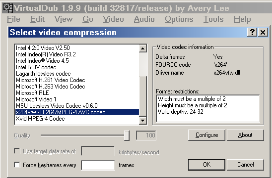

  14. You are running the command line version of x264. That is not what you need to work with VirtualDub. You need to download and install x264vfw:
    http://komisar.gin.by/old/1732/x264vfw.1732kMod.generic.x86.exe
    That's the version for 32 bit Windows and 32 bit VirtualDub. Once you have installed that x264vfw will show up in VirtualDub's compression dialog.

  16. If you want maximum quality and don't care how long it takes use the "Placebo" Preset. Under Tuning select the type of video you are compressing. Profile and Level can be left at Auto. If you want a fixed file size and don't care so much about quality use Multi-pass bitrate encoding. If you want quality and don't care so much about file size use single pass CRF encoding. They are two sides of the same coin: when the two methods produce the same file size, the quality is the same.
