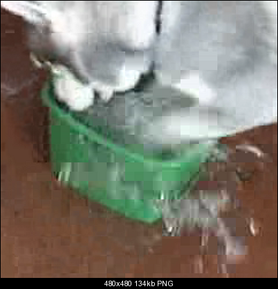

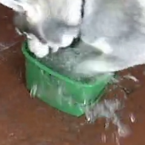

  5. With Divx/Xvid encoding the picture breaks down in to blocky artifacts as the bitrate gets too low. With h.264 encoding small details blur away.
    original 2x (all nearest neighbor enlargements):
    Xvid:
    x264:
    Note, these are not the same level of compression. Just random settings to show the type of artifacts you get.
