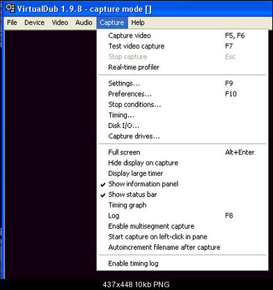

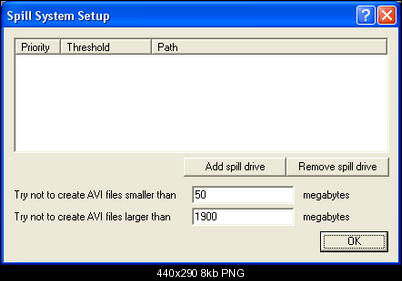

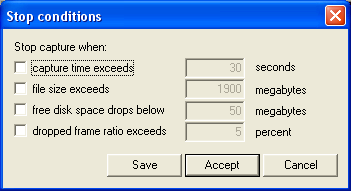

    Originally Posted by Tobes View Post
    I guess my last question is... is there anyway to make adjoining the segmented .avi files easier? Do I even have to join them together? Is it possible to capture and save as one file greater than 2gigs? This part of the process seems almost redundant and takes a decent chunk of time with a 20gig file.
    These are my settings for unlimited file size:
ID:	3309Click image for larger version
ID:	3310Name:  _stop.png
    Am I just looking at it wrong, are theses segmented files actually considered one AVI? When I go to open the first one it opens all of them as one AVI.
    With Avidemux or VirtualDub open the first part and then append the other parts.
