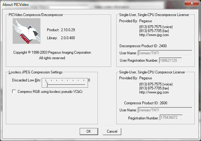

  21. Hi guys,
    I have a codec question for you. Below is a screen shot of the configure screen for the PICvideo LOSSLESS codec. I cannot seem to find a help file or any online help that refers to what exactly changing the bit threshold does/changes. Any ideas? Also, the color space option.....Premiere is going to change that any way right? So there's no need to try and force it to remain in the same mpeg2 color space right?
    Thanks.
  22. As far as I can tell, the "Discarded Low Bits" settings doesn't do anything. Using VirtualDub and PicVideo 2 LJPG the output files were bit-for-bit identical with the slider set all the way to the left and all the way to the right. Same with PicVideo 3 LJPG. The decompressed videos were identical too.
  23. Thanks for checking on that for me man. I will just leave it alone the, leave it at the default.
    -vodmare.
