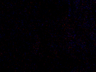

  1. hi i am new to the whole editing video scene and i was wondering if someone could help me take an old video i have that is really dark and quite grainy and brighten it or least tell me if it can be saved i have tryed alot to get it to look better but nothing seems to work... i would love help thanks.

  4. what do u mean i am sry if u sound dumb to this but i really am i have tryed on my own to figured it out but its starting to give me a headache
  5. he means you should upload a native, unprocessed video sample , because the method in which you take a screenshot or re-encode a video might have already thrown away some information. Your best chance at recovering anything meaningful is to look at the original video
    you can upload a video sample directly to this site if <30MB , or use a 3rd party free hosting site if >30MB (e.g. mediafire.com, sendspace.com)
    (although if that screenshot is even a remote indication, I would guess this will be a futile exercise)

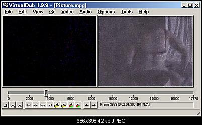

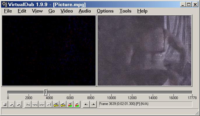

  9. VirtualDub and Neat Video can tease a little bit of detail out of it:

  10. That's a much better job , jagabo, I guess I'll eat my words
    What settings /filters did you use?
    I think you should have advanced a bit more into the clip
  11. Normally I would have used AviSynth to open the video and ConvertToRGB(matrix="PC.601") but I got lazy and just used VirtualDub directly because I know that its Brightness/Contrast filter works in YUV and can boost the brightness (7 or 8 percent) without losing blacker-than-black. That gets blacker-than-black high enough so that it isn't crushed when converted to RGB for further filtering. I then used the levels filter to adjust the contrast and gamma. I don't remember the exact numbers but it was something like 0, 1.3, 28, 0, 255. Finally I applied Neat Video with strong temporal and spacial filtering. I used a shot with no recognizable detail (just noise) to "train" Neat Video. There wasn't much motion in the shot that I posted so the temporal filter didn't blur the image. That was one of the brighter parts of the video so you're able to make out what's going on. Unfortunately, later shots were darker and didn't have much detail to enhance...

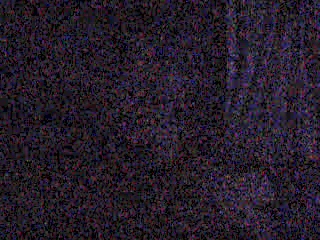

  20. Hi everybody,
    I'm a new forum member and I need help to improve the quality of a very dark and grainy video.
    In particular, I need to find out who is the guy with the light crossing my garden in the night.
    I have tried a lot to enhance it but with no luck.
    Could anybody help me with this?
    I really appreciate your help!

  23. Here's what I got with a little brightness, contrast, and gamma modification. Not recognizable. If you reencoded that video for upload I might be able to get something better with the original clip.
