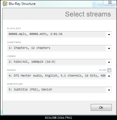

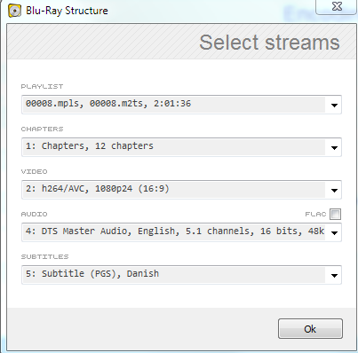

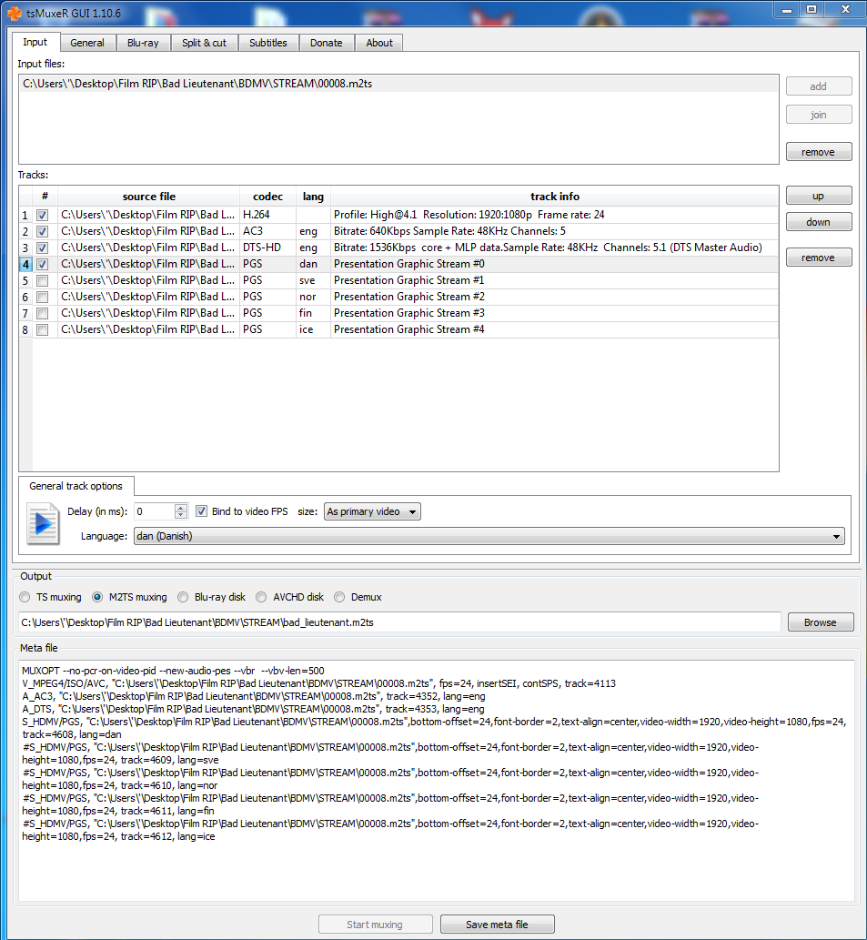

    I Rip the BlueRay disk with AnyDVD HD
    then i use tsMux to select only the movie and the sound with the Danish Sub (as u see here)

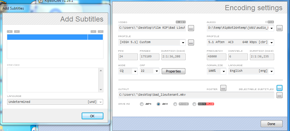

    Then i used RipBot264 and selected the sound and the sub again (as u see here)

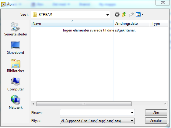

    Its run for 10 min. and then i look on the encoding settings page and will add the sub, but when i hit the (+) there is nothing its want a SUP. SRT. file and i can't find a file of that filetype in the BlueRay rip folder or on the dics itself, where do i find that SUB file have tryed to use SUBRIP but it also want a SUP og SRT file and the file can't be founded on the disc or the Rip folder.

    Having not really used Ripbot, all I could add is that it appears that ripbot is muxing the PGS subtitle into the MKV. Unless Ripbot OCRs the PGS and converts it to srt, the subtitle will not play. If it doesn't OCR the PGS that you would have to do it yourself and insert that into ripbot or you could just leave it as an external srt in the same folder and with the same name as the mkv.
