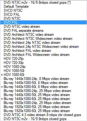

    The only way I DO get a widescreen video is by choosing DVD Architect PAL Widescreen Video Stream - but this doesn't export with any audio. This setting states Audio: none. How bizarre is this - why no audio?! Who wants a video which deliberately exports with no audio?????????????
    Is there a way in Sony Vegas Platinum 9 to get a DVD PAL video to export as Widescreen with audio included?

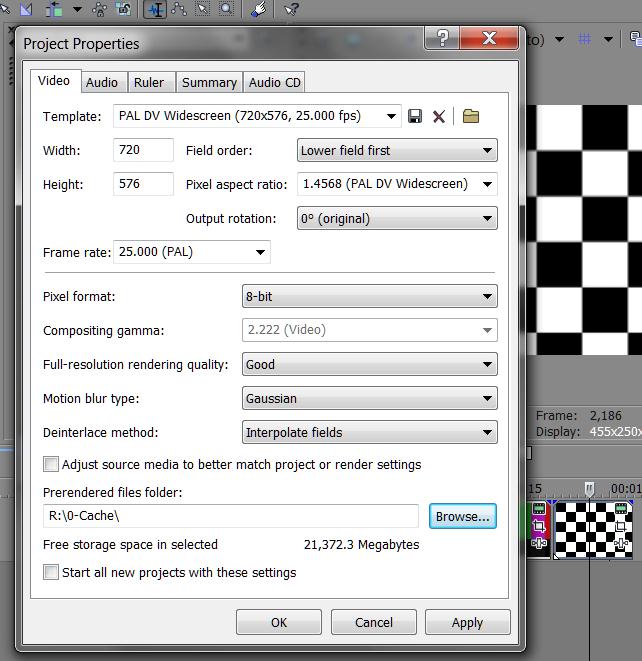

    Let's start with the 720x576 16:9 camcorder file (appears horizontally squeezed when viewed square pixel).
    First you need a 16:9 project setting (PAL DV Widescreen) and the clip properties need to show 16:9 1.4568 PAR. That results in a 16:9 preview window. Next when you export encode to 720x576 DVD Mpeg2, you set aspect ratio to "16:9 display" and you get a wide DV format MPeg2 ready to be imported as a asset into DVD Architect.

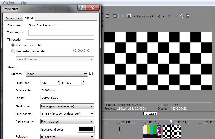

    If your source file is letterboxed 4:3, you need to process the clip to wide spec by stetching vertically to fill the frame, then change properties to reflect the new 1.4568 PAR (PAL DV Widescreen)
    The checkerboard test pattern is useful to view PAR. The boxes should appear square.

    There isn't a setting for aspect ratio to "16:9 display". There is a drop down box with preset (inc. DVD PAL and DVD Architect PAL Widescreen Video Stream).
    Although the preview shows the video in 16:9, the end file is:
    DVD PAL = 4:3 with audio.
    DVD Architect PAL Widescreen Video Steam = 16:9 with no audio.
    (DVD PAL in Corel and Cyberlink produce 720x576 correctly displaying 16:9).

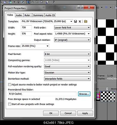

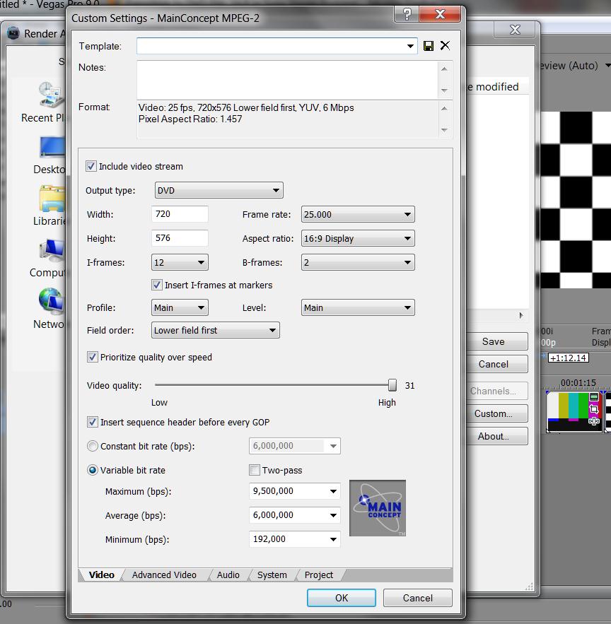

    My test project setting

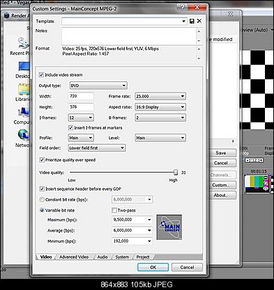

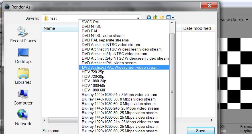

    Render As

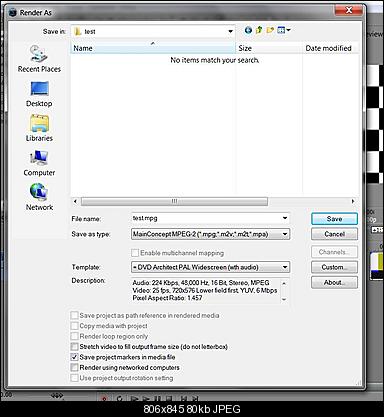

    Defaults for DVD Architect PAL Widescreen
    http://www.kiva.org/about
  11. I've tried those very settings in your screenshots. It creates what I'm after. There's one problem though...
    The DVD Architect PAL Widescreen video stream doesn't contain an audio track.
    Description:
    Audio: None
    Video: 25 fps, 720x576
    Use this setting to create a PAL Widescreen video-only MPEG-2 file compatible with DVD Architect.
    I really do appreciate your helping on this problem.

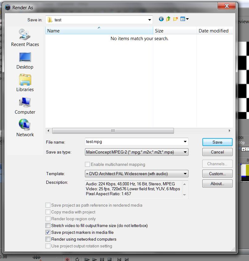

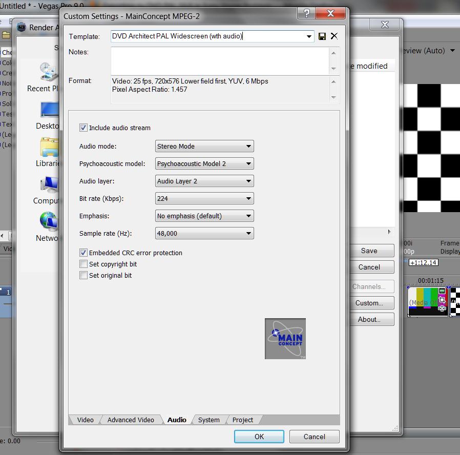

  12. Member edDV's Avatar
    Mar 2004
    Northern California, USA

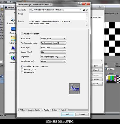

    To include audio, create a custom template with "include audio" checked.
Name:	PALW_enc_with audio.jpg

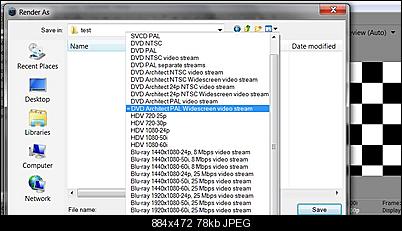

  13. I think I'm nearly though now. I've gone into Advanced Render.
    The only problem is I cant choose 'custom' for the DVD Architect PAL Widescreen video stream.

    My custom template result.
Name:	PALW_enc_render_with audio.jpg

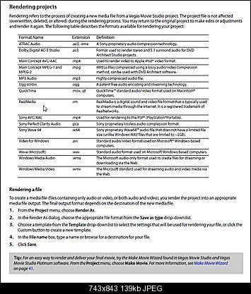

  24. Member edDV's Avatar
    Mar 2004

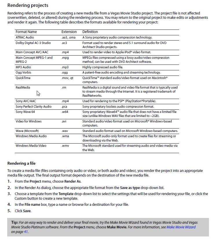

    According to P-46 of the Vegas Platinum Manual, you press the Custom button to create a new template as I did.
    Try to figure out why yours is greyed out. Is this the demo version?

    if you don't want to make dvds, there should be other templates you can use to create mpeg-2 with audio. vegas pro has these, platinum should have some of them. choose dvd pal or default and see if the custom button is active.

  30. As I mentioned in #26, custom profiles for DVD PAL (MPEG2) cannot be done in Sony Vegas Platinum.
    Only the expensive PRO has this custom option for DVD PAL (Widescreen or otherwise).
    It cant be done so this thread can now go no further. I will stick with the vastly cheaper Corel and Cyberlink which can do what I want (without Sony's extensive range of transitions).
    Thanks for all the replies.
