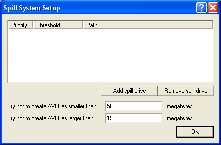

  8. I have version 1.9.8 of virtualdub. How do I get it to not split in 2gb files? My hard drive is ntfs, I checked. In vdub, if I click on 'capture' and scroll down to 'capture drives', where it says 'try not to create avi files larger than', the biggest it lets me enter is 2048mb. how do i disable this feature?

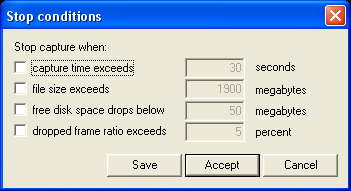

    May 2007
    Romania
    From capture menu see:
    Stop conditions
    Captures drives..
    Also see "Enable multisegment capture"
  13. ok, so i just unchecked "enable multisegment capture". It worked! So, now I have one file that is 12gb for 1/2 an hour. Thank goodness. I finally made some progress. I'm now going to encode with tmpgenc and hopefully it shrinks it to something i can work with. I'm going to use 9000 bitrate. Is this really going to bring it down to around 2gb? This is what I what I would need to put 1 hour on a dvd, right? Do I need to convert the audio to AC3 after encoding with tmpgenc?
