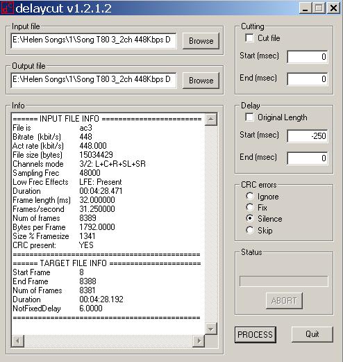

Probably not. You just have to configure it. Open MPC HC and right-click on the screen. Go Options->Audio Switcher and check 'Enable built-in audio switcher'. Close the player and reopen it. Play something and now, with any luck, you can use the +/- keys to adjust the delay and you'll see the amount in the lower left of the screen.Originally Posted by fits79
Once you've found the amount of the delay open DelayCut and under Delay/Start, fill in the amount of the delay. It's not necessary to fill in anything else. Then hit 'Process':
