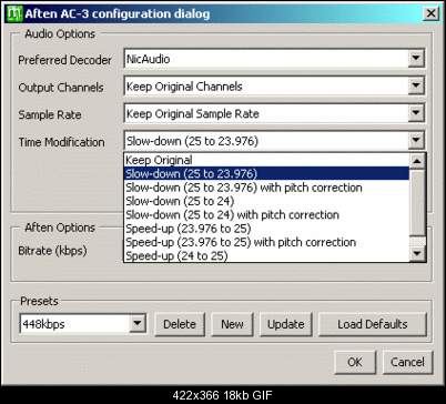

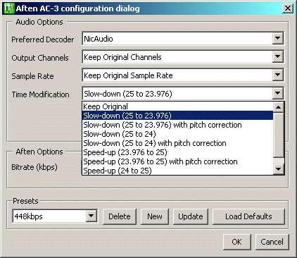

    If that's not an option you'll need to re-encode the audio. There's probably quite a few programs which will do speedup and slowdown while re-encoding. The only one I can suggest is MeGUI as it's what I'd use. It's audio encoder configuration looks like this:
    For PAL to NTSC I generally do it without pitch correction as there's usually no way to know if the audio was pitch corrected when it was sped up in the first place (unless you have an NTSC version to compare it to). I think generally it isn't, but as I said, it's hard to know.
